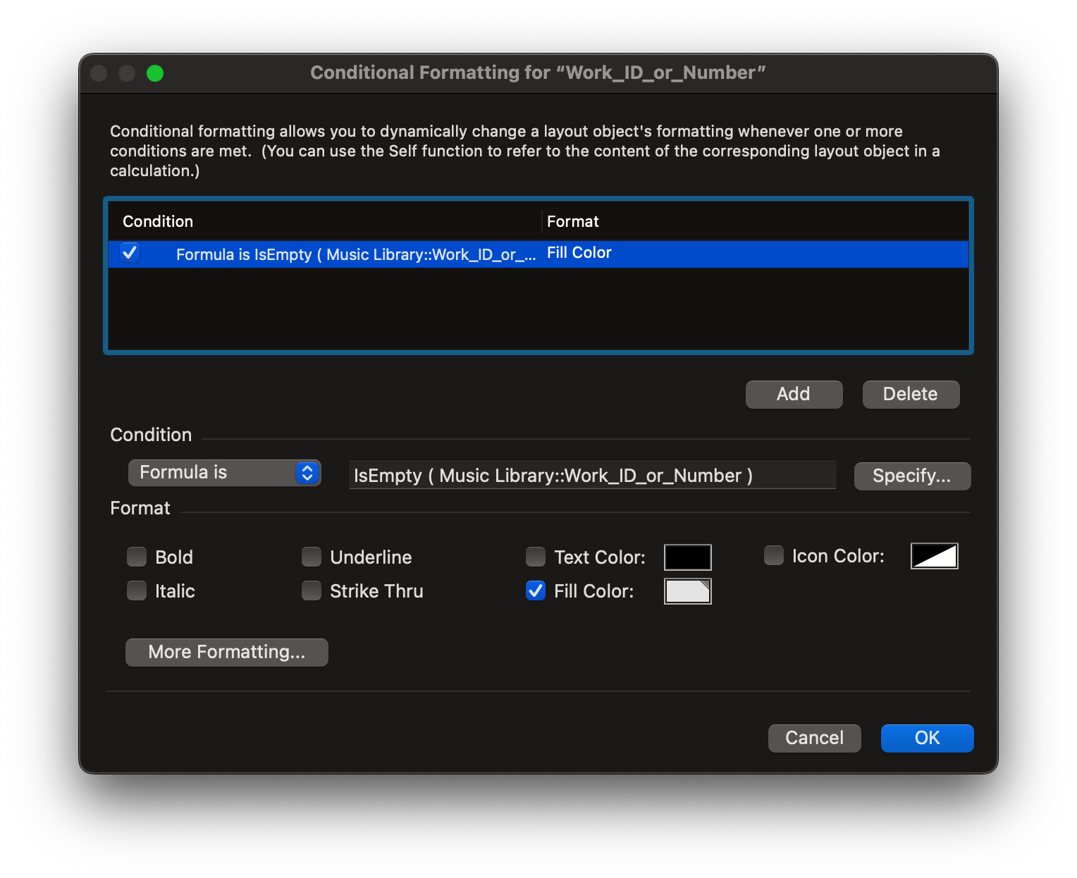

I've been exploring Conditional Formatting, and it seems that applying "Value is Empty" with a Fill Color red gets me closer to what I need. However, I'm still grappling with the red outline and the layout object on the right side.

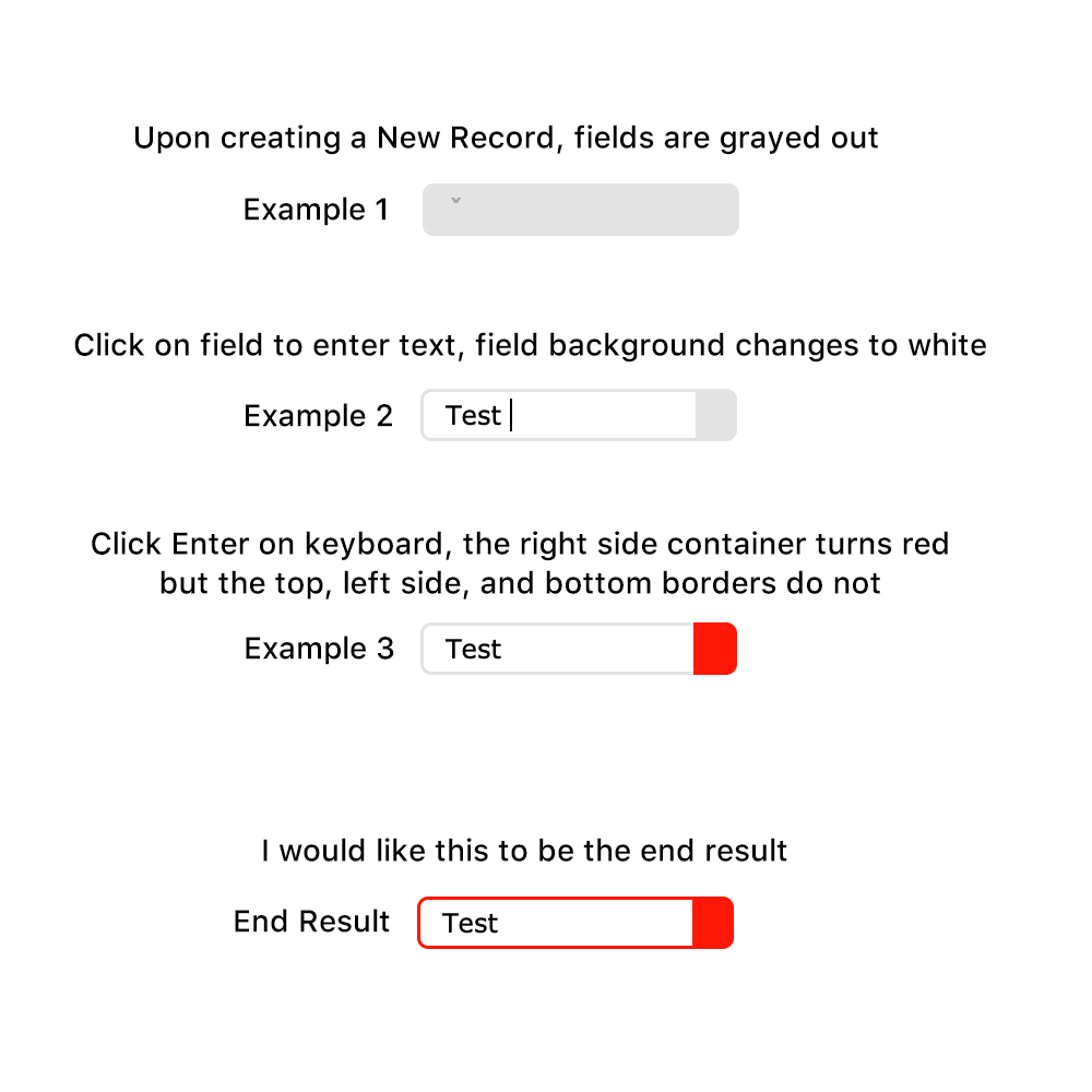

I'm almost there, but I'm struggling to achieve what feels like a simple solution. I've provided a screenshot with three examples and the desired end result. While I've managed to figure out examples 1, 2, and 3, I'm having trouble getting the top, left side, and bottom gray borders to turn red upon exiting the field (by pressing Enter on the keyboard).
The field consists of two parts: the field itself and a container on the right side for display only. I'm using a container because several fields are within portals, and unfortunately, the Web Viewer doesn't function within portals. Additionally, I can't apply Conditional Formatting to a rectangle, which feels like a limitation considering it's 2024.
Both the field and the container have Conditional Formatting, as depicted in the attached screenshot. This setup seems correct, as the container's formatting works perfectly. However, the field gray borders don't change as intended. I've also tried "In Focus" under Appearance but that doesn't seem to fix the problem.
I'm hopeful that someone can provide guidance on how to turn the gray borders red upon exiting the field. Thanks a lot for any assistance.

I am afraid this is too confusing for me.
Let me restate some of the governing principles here:
  • The style applied in the Inspector is affected only by the field's display state (Normal/Hover/Pressed/In Focus);
  • Conditional formatting is affected only by data (incl. environmental variables, e.g. current date);
  • Conditional formatting is ignored when the field has focus;
  • Conditional formatting cannot be used to turn a field's border/shadow on and off.

If you mean what options exist for turning a border/shadow on and off based on anything other than a field's display state, I believe the answer is none.
Sure, you could hack a fake border by placing an object behind the field and hiding it conditionally. But that's precisely where I would say it's too much effort for too little return. Much more so if the border should also depend on the field's display state. That would require script-triggered refresh on each field enter and exit and probably an array of variables to hold the current state of each field. That's exactly what I warned against in my very first post in this thread.

It seems I've managed to get things working as I imagined. I simply opened up the container, moving it towards the left, and tucking it behind the field. Then, I adjusted the height of the field slightly. Now, when there's text in the field, I finally see the red border I wanted. When the text is cleared, both the field and container turn gray. I'm hoping that this method will make everything function as intended. I appreciate your advice and help with this, comment. Thanks.
