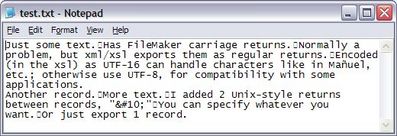

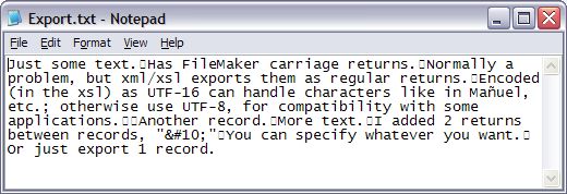

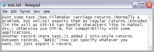

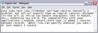

I'm still having a problem, though. Both with your sample exported file and my own test export with the XSL, I see small squares (rather than returns) when I open the files in Notepad. The only real return is between the two records if I'm looking at this properly.
I'm attaching pictures of both files opened in Notepad for you to look at. What am I doing wrong?
Try switching to UTF-8? I believe it can handle "characters like in Mañuel" just as well.
Mine does not handle Mañuel with UTF-8. But, if you want to change your encoding, it's in the xsl stylesheet in this line:
Just change the 16 to 8.
It seems Textwrangler and BBEdit have problems recognizing the file encoding - they think it's 'Western (MacOS Roman)', for some reason. But if you choose 'File > Reopen Using Encoding... UTF-8' it's fixed. TextEdit works fine with no adjustments.
