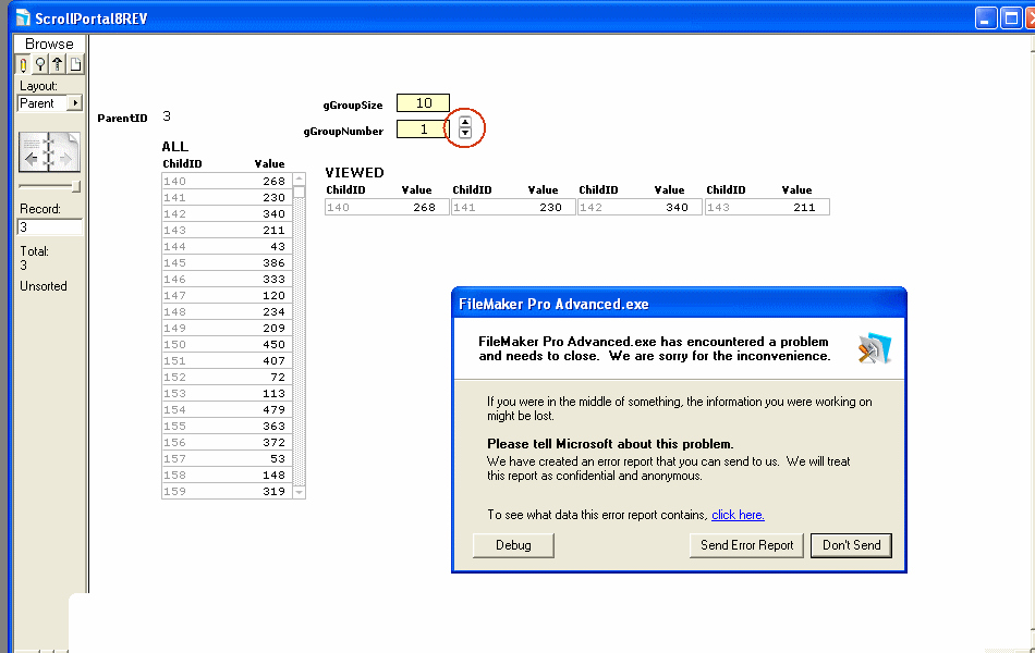

Everytime I click the up or down buttons on the layout, even if I'm in layout mode, Filemaker crashes on me. Happening to anyone else?
Hmmm, works fine for me. What vs. are you using? I don't recall any unexpected behaviors regarding portals. Maybe try downloading another copy? :wink2:

I downloaded your example and my system blows-up every time I mouse over your up/down scroll handles. I took a screenshot and drew a red circle around the offending object. See the attachment.
I'm running FMP8A on Windows XP SP2. The hardware is an HP 7600, Pentium 4, 3.4GHz w/ 1G RAM.
It happens within 1 second everytime I mouse over it. I don't click, just simply a mouse over that object and FM abruptly ends every time.
I've seen this happen on stuff designed by other FM developers before. It seems to be connected to non-native FM graphics.

Is Forums still crashy for you? I keep crashing - and I crashed several times while trying to attach the file ... I wonder if it's connected!!
Went back and downloaded comments file, it todes the same thing. Something with that graphic is causing it to crash. It doesn't even matter if I'm in layout mode.
So, its not your fault LaRetta! It wasn't anything you had changed.

FYI. I crash in Layout mode as well. If I delete that graphical object everything is fine.

Really! I had assumed that they were built using something else. So those up/down scrolling do-dads are just made from native FM lines, rectangles, etc? Were they made in an earlier FM version? If so do you happen to remember which?
I tried ungrouping them but it still crashes.
IIRC, they were made in 7.0v3. How do you fare with the original file?
Same problem in the original.
I have narrowed it down a bit. What I did was zoom in to 400%, window around the entire object and ungroup until "ungroup" was greyed out. That was 3 times I think. I then picked the assembly apart by windowing around the tiny individual objects and moving them with the arrow keys. Once the whole thing was completely exploded I ran my pointer over each object one at a time. All are fine except for the tiny 1px line(?) or rectangle(?). There are a couple of those in there and when I mouse over either of them it is an instant crash. Using the Object Size window I changed the horizontal length to 2px and the problem is solved.
Now what I'm going to do is create my own 1px line using v8 and see if that crashes too.

I just created a brand new file using FM8Av2 on Windows XP. I have no other applications open, only Filemaker. I immediately closed the Define Database window. I went into the layout mode and created a horizontal line. I opened the Object Size window and changed the horizontal size so it is 1px long. I went into browse mode, moused over the object and its CRASH CITY.
Any ideas?

Just for grins I recreated a 1px horz line on my home PC and to my great surprise IT CRASHED TOO. There is a big difference in my home and work machines. I'm running W2K on a much older Dell box. I have Homesite on both but Zero said that he didn't run that software.
Do me a favor and just create a 1px long horizontal line on a brand new file. Mouse over it and see if you crash. I'm really curious.
Okay. I created test file and 1 px horizontal line. Then I ran my system to smokin-speed ... moving the line around, saving layout; placing line on header line; exiting FM and even rebooting - everything I could think of, I tried. No crashy ...
Then I switched my res to 800 x 600 (from 1024 x 768), rebooted, and again worked it hard. Nada.
Okay, now try my idea and see if there is a difference. If not, it could be a tough cookie to pin down - just like the moving phone issue. :wink2:

I followed your exact steps as requested; going in and out of the layout mode where noted, CRTL + X, Send To Back, ungrouping, the whole works. It crashes instantly when I mouse over the object.
I also tried sending to back on my other file which contains a single 1 px long horizontal line and nothing, and I mean NOTHING, else. It still crashes too.
Very strange.
