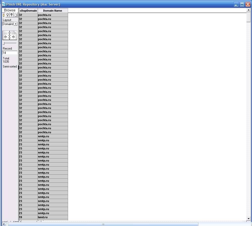

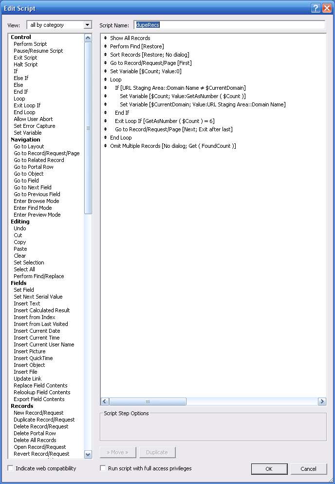

Making Progress, Here is what I have done;
Created following Fields:
Created a Self Join relationship "URL Staging Area::Domain Name"
cDupDomain = Calc, Unstored, From URL Staging Area, = Sum (Domain Dupes::One)
One = Calc, from URL Staging Area, = 1
SumOne = Summary = Total of One
I will just attach jpg's of both the scripts and result.
Just want one of each record to display, and would like to have in a portal.
