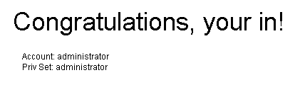

So much for that.. I'll be back.
And the answer is not certain at this point.
I invite other people to continue trying to get in -- I now know of only one method to do it. You're going to have to get very creative.

I just tried that and it doesn't work. If your right and it does work (which it probably does):
A) That's a real password and i set it to something simple so i wouldn't forget (but i did forget ... god i'm dumb)
:) That's a privelege password -- It'll get you into the front end but that's it. You have no access to the backend
sorry, Genx, I don't speak English.
What user name and password did you use though?
Because the only account with the same user and password in backend and front end was the administrator account.
... and i tried administrator administrator and i can't get it to work

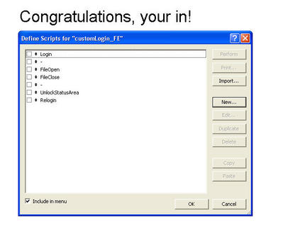

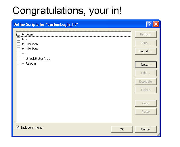

for bypass your custom login screen I executed hidden script "unlock status
area"
et voilà.
Now, in your example, you can remove script "unlock status area" but in a large
solution there are many hidden scripts and I can execute one of this for bypass your
custom login screen.
I suggest you don't use custom login screen.
Bye :)

In a larger solution, and in this one for that matter, that script shouldn't have been available for welcome users. Looks like i just forgot...
Thanks again.

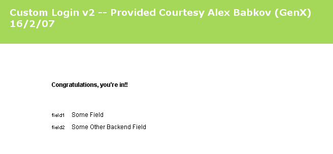

A revised file is now available -- See original post for new file

The reason being.. My main concern here is that that layout is not accessible to the welcome account at all -- i.e. it's blocked. So even if you had bypassed the script and managed to get to it, you shouldn't have been able to view the layout -- Whether you were using a custom login screen or not.
Can you please PT me a screenshot of the bottom portion of the layout?

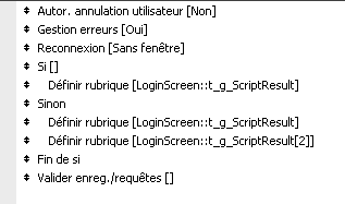

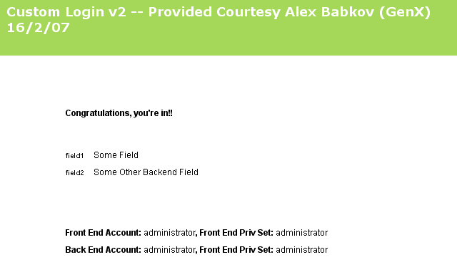

So you actually logged in? Those calcs are pulling the real privilege sets... I'm at a real loss as to how you did that... Like i said, administrator accounts force you to login twice, using only FileMaker login.T

Well last time you got in by unlocking the side bar... what did you do this time?
Genx, what do you hope to accomplish that FileMaker's own Privileges won't give you? You are attempting to reinvent the wheel that FileMaker Engineers have already invented (very well, I might add). It may not be totally uncrackable (nothing is) but, if THEY can't make it uncrackable, what makes you think YOU can?
I'm at a loss to understand ...
LaRetta :wink2:
relogin
