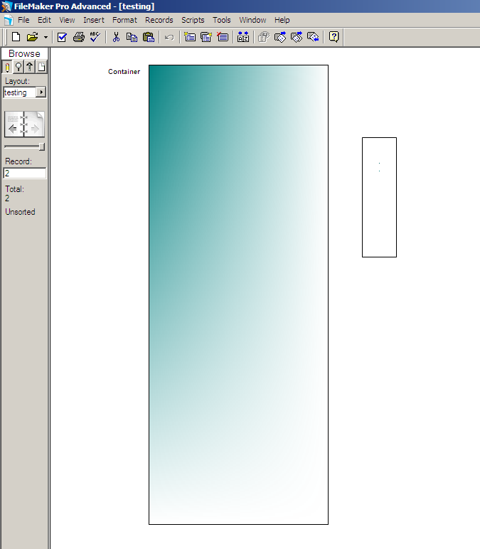

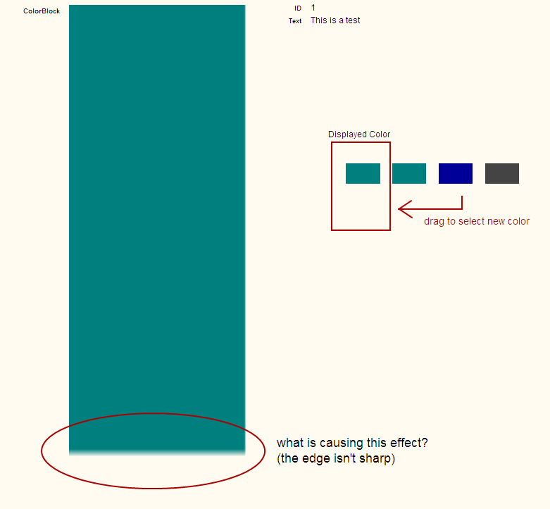

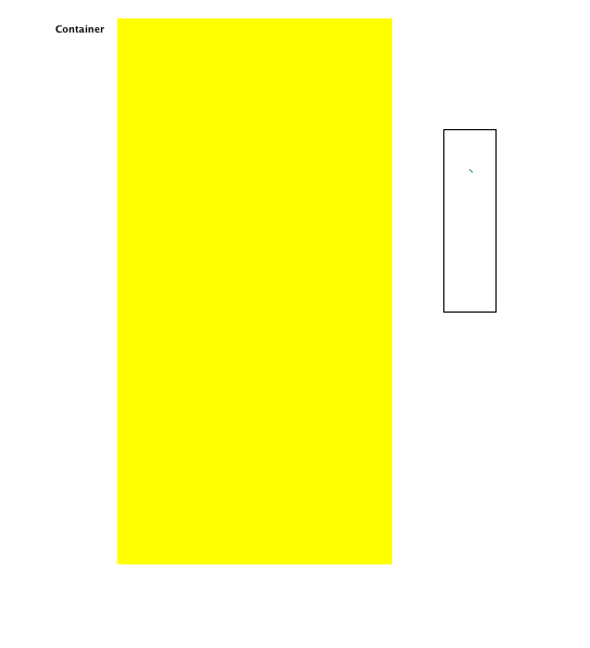

I'm trying to use colors held in a container field to colorize large areas on layouts. As shown in the screen image file below, there is a strange effect showing up along the bottom edge of the displayed results. I've tried various combinations of Enlarge settings with no improvement. A sample file is attached.
Would anyone know why this is happening? Is it an "undocumented feature" that serves some purpose?

Video Card maybe. It is sharp as a tack on my Mac.

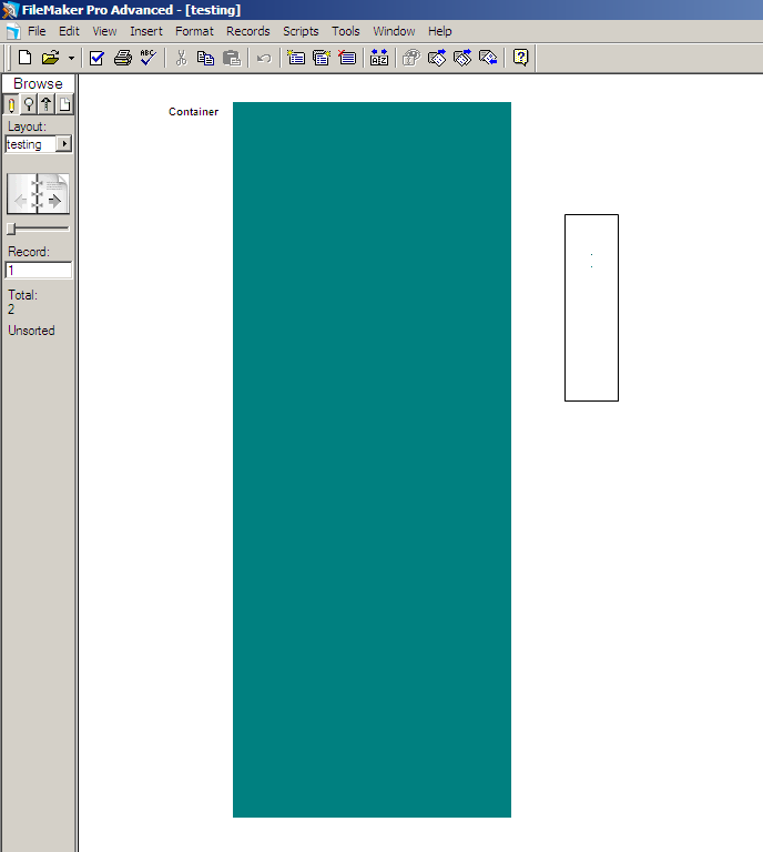

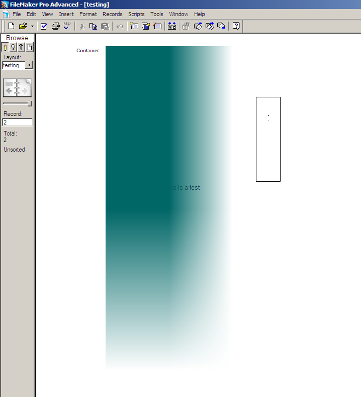

K1200 - just to eliminate other possibilities, can you report what you get with the attached file? Please examine both records.
testing.fp7.zip
Comment, here's the result on my PC. Both records look the same except for the slightly darker color on the second one.
Oops! ... Here's an update.
I went into layout mode and grabbed one of the single-pixel color swatches ... and then returned to browse mode and pasted it into the container.
This was the result:
That IS strange - what exactly is involved in "grabbed"?
In layout mode, I right clicked on the lower of the one-pixel colors inside the vertical rectangle and selected "Copy". Then I changed to browse mode, clicked inside the container field to select it, then right clicked and selected "Paste Layout Object" -- which produced the transparency effect. (I say transparency because a text field placed behind the container shows through, so it's not transitioning the color from green to white but rather green to none).

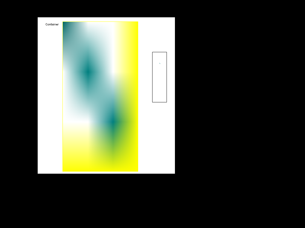

UPDATE: It just went from strange to weird when I edited one of the colors to be a 2 x 2 swatch (instead of 1 x 1). Here is the result:
added update

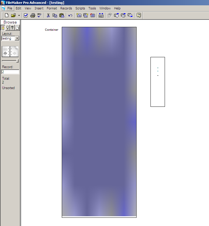

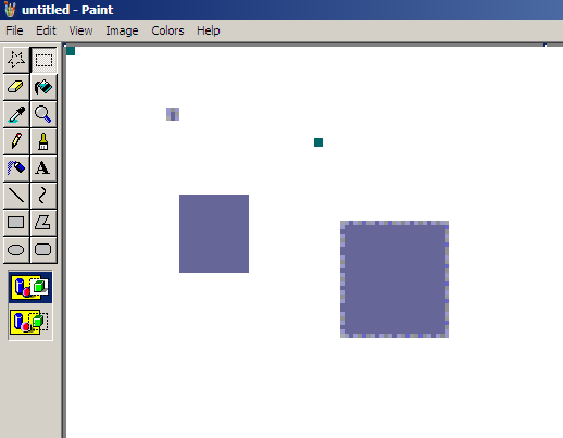

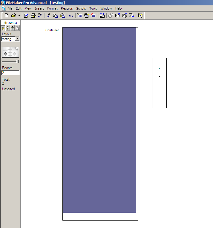

Latest Results: I copied a 2 x 2 color swatch from another application and it ALMOST fills the container. Different problem ... but I still don't have a usable solution.
added remark and new results
I tried creating the image from outside FM, and inserting the image in the container field via 'Insert Picture'. Same result.

OK, this is what I've come up with:
1. If the Source is from inside FileMaker (e.g., those one-pixel swatches) the source has to be larger than the Destination container. Otherwise you get a "transparency fill" in any dimension that was short.
2. If the Source is from another application (e.g., MSPaint) filemaker attempts to fill the Destination modulo the source dimensions. There is not a transparency effect; the container will be blank after the integral is calculated.
3. FileMaker's algorithm does not like fractional Source dimensions (e.g., 3.5 x 3.5 pixels) -- which produce anti-aliased objects. The ArtisticResult.png was produced with a 6.5 pixel color source. ... so it's "garbage in, garbage out". It pays to confirm the Source Color with an application like MSPaint, which operates, literally, pixel by pixel. (See the ColorSources.png for an example)

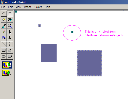

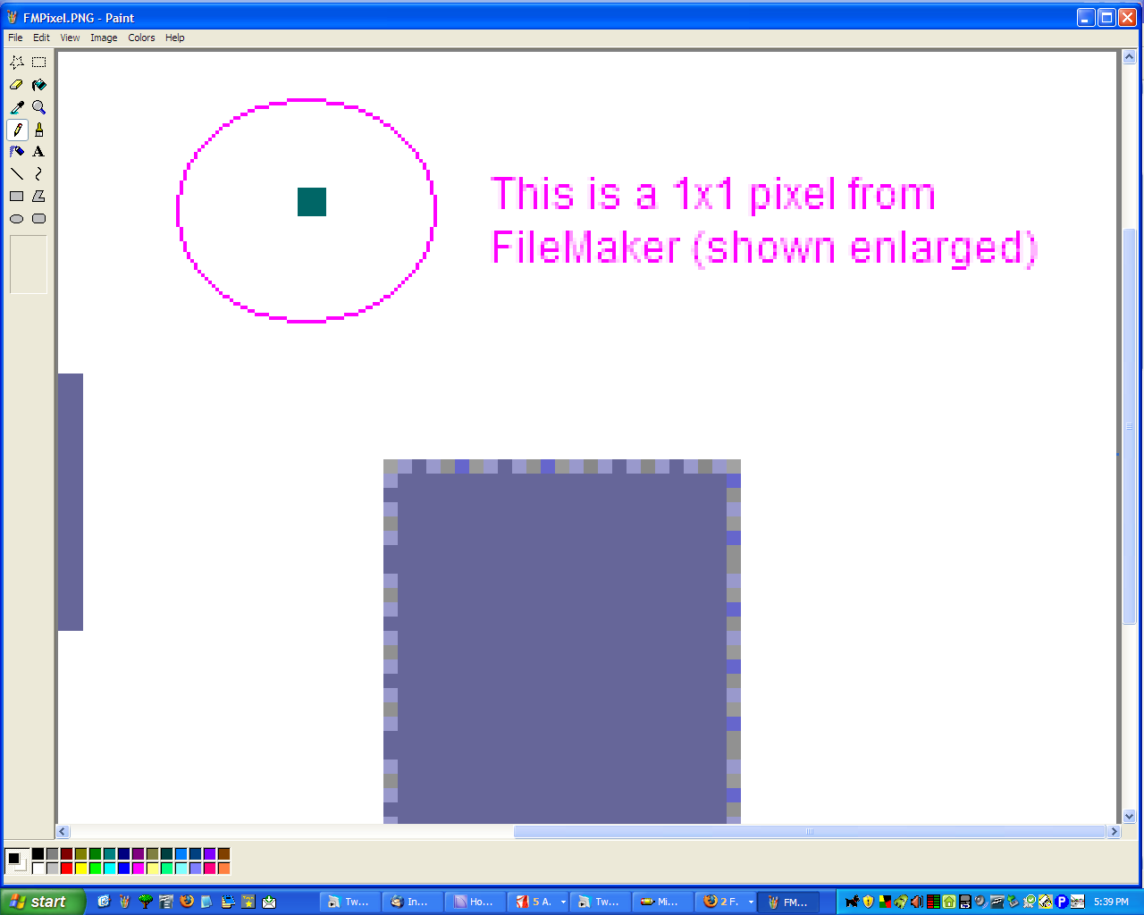

One thing that would be perhaps interesting to see, is an enlarged contents of the container after pasting (i.e. paste a 1x1 FM rectangle in, copy it, paste it in a paint application and zoom in).
My theory is that Filemaker forces anti-aliasing on the pasted object, then stretches it out (instead of the other way round).
Comment, I had looked for that ... but didn't notice anything when doing a 4x zoom in MSPaint.
But is that a pixel that has been copied from the insides of a container?
No, it wasn't at the time.
However, I just ran the test you suggested (i.e., setting the container to allow the pasted object maintain its original size) -- and the object grabbed from the container and pasted into MSPaint is exactly the same.

And as one more test, I loaded your file and (only) changed the container to Reduce + Maintain Original Proportions.
When I went to browse mode, there was the lone pixel displayed in the center of the container. I cut/pasted into MSPaint and it was intact.

It seems the bug is that Filemaker picks up the anti-aliasing when copying its own native objects.
