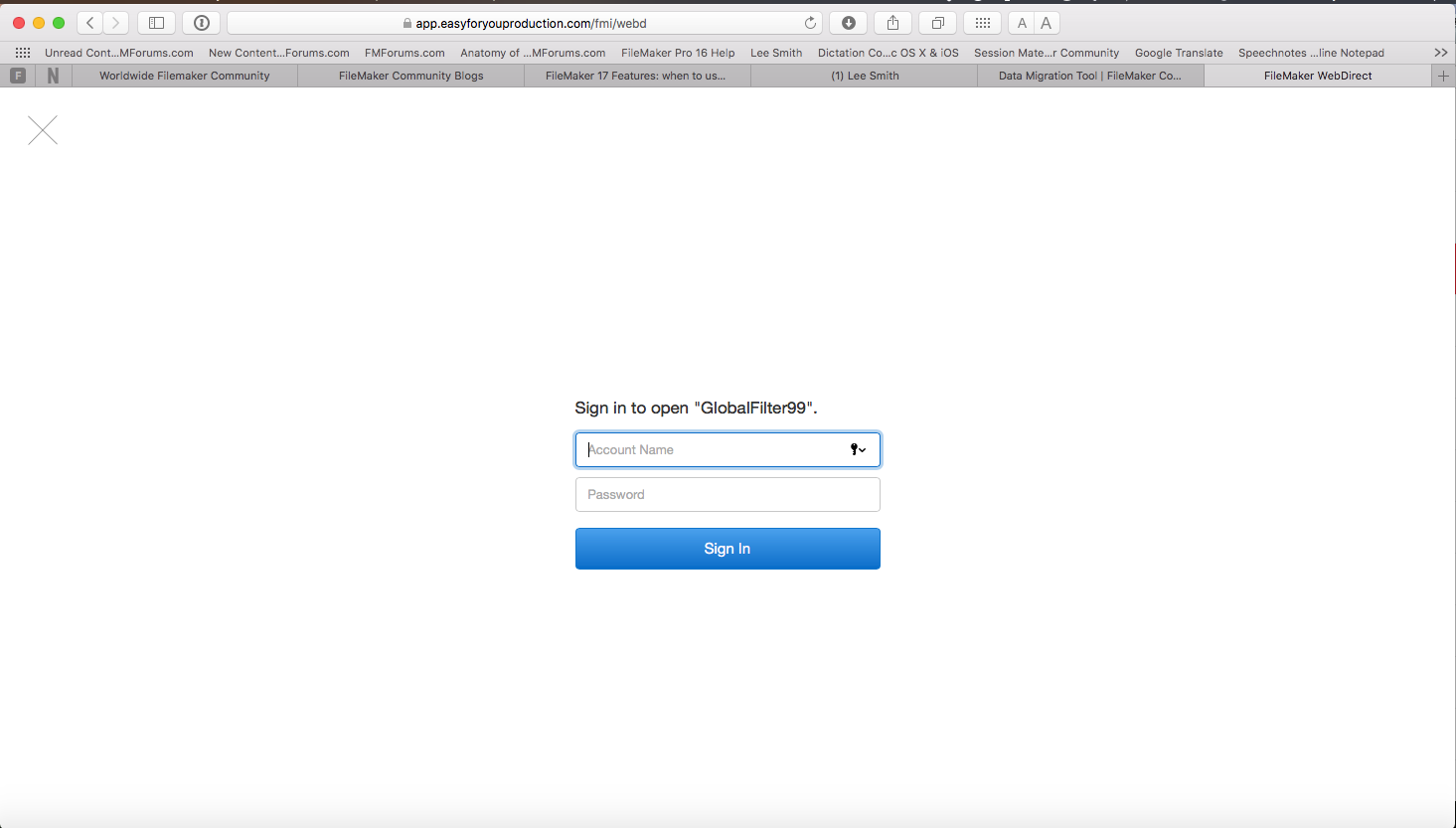

You can see an example in this link:
https://app.easyforyouproduction.com/fmi/webd/GlobalFilter99

Okok,
I only link to the webdirect solutions because is more easy to check this issue with several users.
