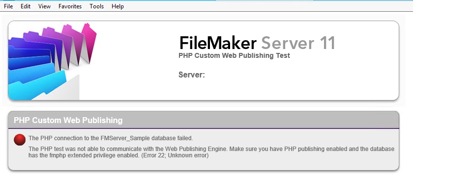

However, when I run the PHP Custom Web Publishing Test, I get the page displayed correctly, (PHP is working) and it identifies the name of the server, but below the main information box, I get the following error message:
The PHP connection to the FMServer_Sample database failed.
The PHP test was not able to communicate with the Web Publishing Engine. Make sure you have PHP publishing enabled and the database has the fmphp extended privilege enabled. (Error 22; Unknown error)
The sample database is installed and it is listed in the admin console, status, normal and dots across the line. I can't imagine that it wasn't installed with the correct Extended Privileges for CWP and I would not be 100% confident to know what I should check for.
I am viewing the CWP Test webpage on both the server and a client and getting the same error message.

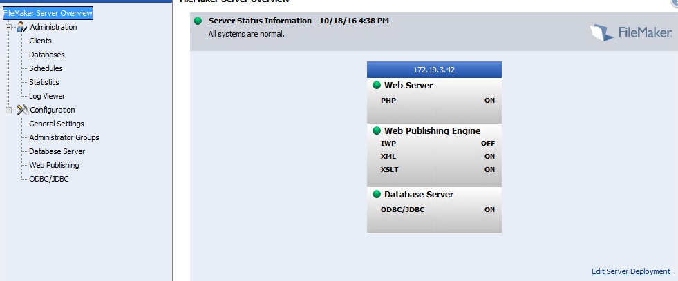

Maybe I need to explain my issue a bit better. The Status page has a green tick next to the Web Publishing Engine, although it shows the WebDirect as disabled.
The box above the WPE is the Web Server, which has no green tick, but a grey circle. This box shows both PHP and XML as disabled.
The config pages for WebDirect, PHP and XML all show these services as enabled.

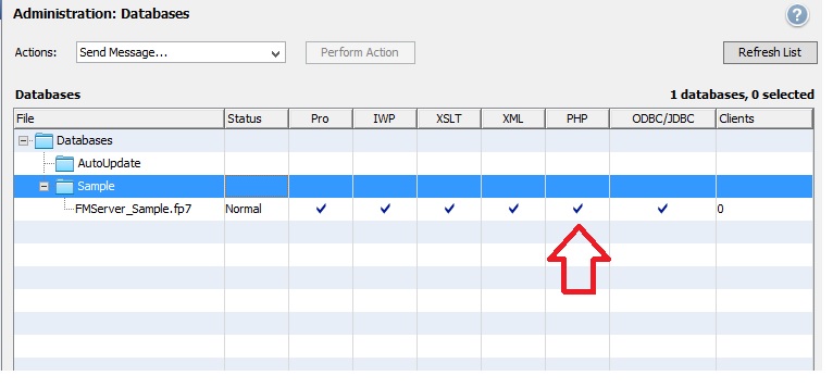

The admin console does show that it is sharing the sample database and that it has got the correct permissions enabled for WebDirect, PHP and XML.

Can you post a screenshot of that?  Just to confirm?
OK, let's see if I can get this to work.
Status.jpg shows the view of the FMS Status screen.
WebPub.jpg shows the view of the config setup page for PHP.
As you can see from the Status.jpg, the WPE has a green tick, however the Web Server box above has a grey circle and shows PHP as disabled.
The WebPub.jpg shows that PHP has been enabled.
Thus my confusion.

phptest.jpg shows the error 22 message that I am getting on the phptest.php page.
This also shows that PHP is working as the server is displaying a PHP page with no coding errors.
sampledb.jpg shows that the sample database is registered with the FMS and that it has all the correct permissions applied to it.
Hope this helps.

Adding snapshots.
