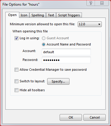

What if you to set the file to launch with a default account? Then you wouldn't need to pass credentials in the webclip. Or does each user get a personalized webclip?

I meant that if you tell your FileMaker file to log in with a default account, it won't be necessary to pass credentials via the URL or store it in the OS keychain. The file itself will take care of it.
fileoptions.thumb.PNG.9b80e7727b7976bdfb

@Fitch That seems to work, but similarly to storing the credentials in the ipad keychain. Unless I "close" the file via script or close manually, whenever I minimize or even force quit filemaker, it will still restore the session last session and last layout the user was on when I choose the webclip. I suppose filemaker go maintains all of the global variables and does some magic behind the scenes to restore the session..Maybe I can attach a script to the webclip url to force a re-login/boot. I'm not sure yet what's best for the users.
Edited by GisMo
It's normal behavior for the user session to be preserved in a single-user file. You'll definitely want to put some thought into this. As a user, I would find it annoying if I needed to send a text or check my email, then came back to find my session evaporated. You mentioned your users were already complaining...
@Fitch I agree. I've also implemented a feature to store the unique deviceID with the User record. When they login the first time, we store the device ID. Subsequent logins search for the deviceID in the user table, if a match is found, we login. If no match, we prompt for password. Also, it prevents more than one device from using the same login.
 Also, with using the method you mentioned above, it maintains that preserved session longer. I think this is a good route..for now.
