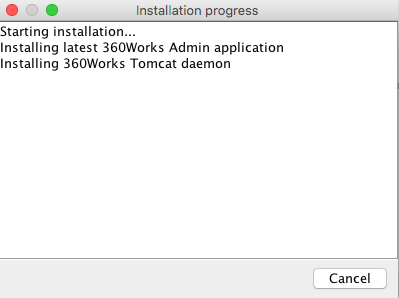

I just upgraded our server that was previously 10.6.8 and running FileMaker Server 11 to Mac OS X 10.11.1 El Capitan and FileMaker Server 14.  I can't seem to get SuperContainer fully installed.  I have downloaded the latest Tomcat and put it in the 360Works folder but the installer still hangs on the "Installing 360Works Tomcat daemon".  I installed the legacy version of Java per some instructions I saw somewhere.  When I delete the 360Works folder and run the installer again it re-creates it but it only has two items in it (360Works Admin.jar and folder named Internal with nothing inside it).
