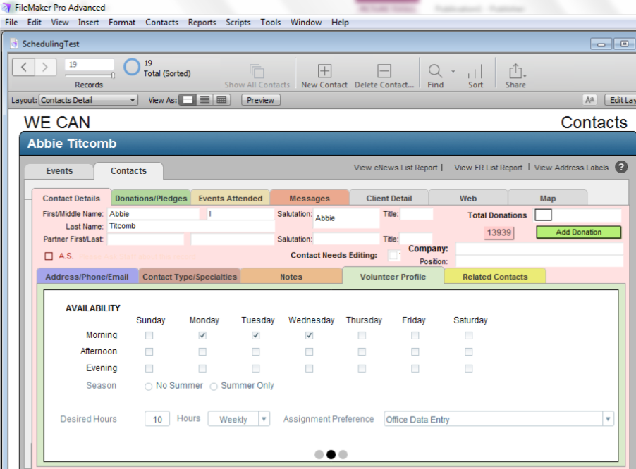

Thank you in advance for your help.  I have a contacts table that I will be adding fields to in order to describe volunteers more fully.  For example, skills, active status, desired tasks.  One of the requirements is a set of check boxes that indicate when the volunteer is available.  The users want the days of the week across the top and 3 check boxes under each one for morning afternoon or evening.  I need to be able to check multiple boxes.  When a volunteer is needed, the users would do a find for the particular time needed.  Here is a screen print of my layout using one field for every value with a Boolean "1" for each checkbox selected.  Is there a better way to do this?

So sorry, here it is!

Thanks so much.  That is what I am doing, since there are 21 individual fields.  My concern was that there might be a better way to structure it.  For example, a Contacts::Sunday field with a checkbox value list of 3 choices (Morning, Afternoon, Evening)?  That would mean I only need 7 fields; one for each day of the week.  Or should I create a separate table for Volunteer availability?  Maybe I'm making this more complicated than it needs to be...

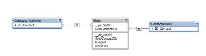

This is pretty slick, I've got it working, but the problem is all 10,000 of my contacts are ending up in the checkbox set.  I also used a TO of the Contacts Table (ContactAvailID) as the AvailableStaff table.
So, to correct that issue, I created another TO of Contacts (Contacts_ActiveVol) that only has active volunteers in it.  The results haven't changed, I still get all the contact records showing up.  Could it be a problem having a structure like this?  Thanks!  Debbie

I am not sure what you mean by that. Only contacts that you have selected as being available in the given slot should appear in the AvalContactIDs field. Of course, if you have formatted the field as a checkbox set, then all values of the value list will be displayed - but only the contacts that you have selected will be checked.
And, of course, if you have 10,000 contacts, then this (display) would be quite unmanageable. But you don't have to format the field as a checkbox set. In fact, you don't even need to show it at all. To see the available contacts from the context of a slot, you can show a portal to AvailableContacts. Or do a GTRR to there.
If you want the value list to show only active contacts, you will need to create another relationship that will make only active contacts related*. In your RG, all Contacts are related, because you are using the x relational operator. Using another TO of Contacts does not change anything.
(*) or use a calculation field to return only active contacts' ID, and base the VL on that.

I am not sure how you have the value list configured, but it looks like the relationship you show going to Contacts_ActiveVol is a cartesian join, which will show all records. Could that be the problem?
