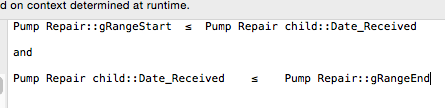

I can't figure out what your question is. If you want to filter a portal (or a relationship?) to only show records within a given date range, you first need to supply the range. If you want to use a drop-down calendar for this, then you will need two global date fields: gRangeStart and gRangeEnd. Then you'll be able to filter the portal by:
SomeTable::gRangeStart ≤ PortalTable::Datefield and PortalTable::Datefield ≤ SomeTable::gRangeEnd
Or define a relationship using the two global fields as the matchfields on the parent side.
Note that in order to summarize a filtered portal, you must place the summary field/s (defined in the portal table) inside a similarly filtered portal.

Ok, fair enough, using the child table summary field is when I'm referring to the "groupings based on the month" previously. As I click through the records at the top left of the database, I notice that my summary field is saying '10' for all the records from the table that are dated in February, grouping them in this manner isn't what I'm wanting.  I'm aiming to have it be based on the RangeStart and RangeEnd global fields I have placed above the portal of course.
As far as the filtered part, I did the exact same setup you had mentioned, using my main table and the child/portal table in the same instances. Having said that, I do NOT have the summary field in the filtering calculation.

Now, with regard to the behavior you describe - that is how it's supposed to work. You are looking at a portal that shows all records that meet the filtering expression. The filtering expression does not reference any data from the current parent record - therefore the portal contents will not change as you scroll from one record to another in the parent table (this is assuming you have correctly defined the relationship to use the x relational operator).

So, after a long while (and plenty of breaks in between) I have noticed my idiotic error of having the wrong relationship. The exact thing you were basically warning me of, wrong relational operator. So I fixed that, made it a 1-row portal and now I can just see all tickets in the given date range, as I was aiming to see originally. Again, I thank you greatly for the assistance and direction on this!
