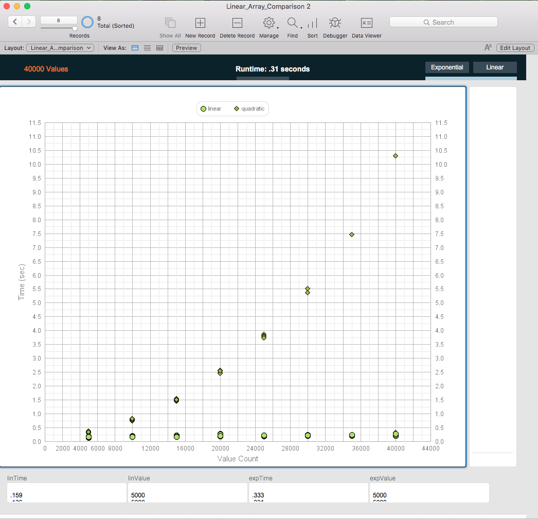

Hey again. In a previous thread I suggested using javascript in a webviewer to return the difference between the server and client UUID lists in order to increase the sync check speed. It was much faster, but the code I used included an algorithm with quadratic time complexity, meaning that as the size of the lists increased the time that sync check took would grow exponentially. @GisMo helped test confirm that this solution would not scale well.
However I think I've found a bit of javascript that solves this issue and will scale linearly. I've changed the script from the previous thread to use this new code instead. If you are using this javascript method for list comparison I highly recommend you change the sync check script to use this code. Simply open the new file, copy the calculation from set variable[ $url ] in "Sync Check Client", and paste it into your Set Variable[ $url ] step.
Otherwise if you're using EasySync and struggling with sync check, give my solution a try!
I've attached the new file below and linked to the old thread for continuity.
Best, Josh
EDIT: For anyone interested in a demonstration of just the algorithms' performance difference before updating sync check, I've uploaded a raw concept file.
Edited by Joshua Willing Halpern
Added a picture.
