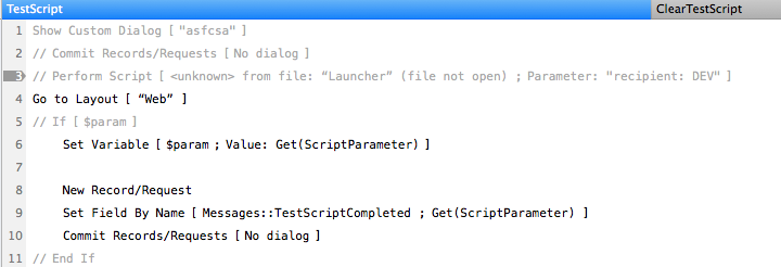

I don't know what Show Custom Dialog will do for you. You're running the script via CWP. Show Custom Dialog isn't a supported script step.
1) Post your FileMaker script
2) How do you know the script is succeeding, just not the parameter?
3) If that's true, there may be a problem on the FM script side, not the PHP side.
1) - For this instance it is the test script: (view the image)
2) - In the test script I ask it to make a new layout then post the ID into that layout (The ID being the PHP_ID sent from the form itself) - The record is created, but no parameter, and you can see that I did an if statement to check whether there was a parameter, and when that was active no record was made, hence there wasn't a parameter, but without it a record is made so it is just the script that works.
