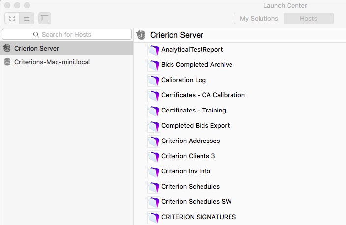

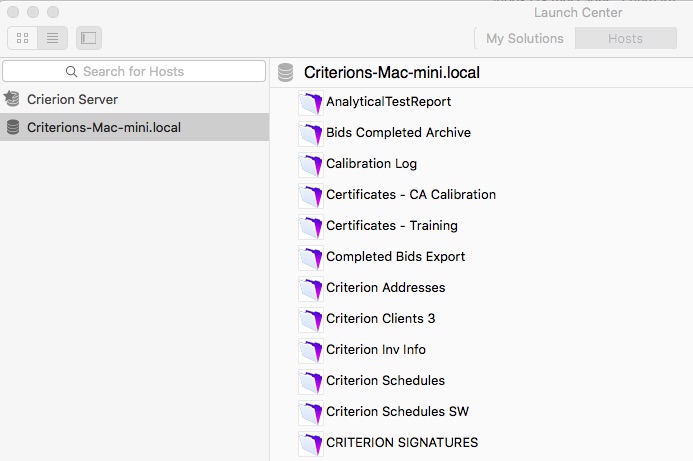

When I open my FMP Client on the system that does not host the FMS files, I see the list of hosted files locally, as I would if I had my own local network.
If I enter the server IP address in the FMP Client too, I can see the list of Internet hosted files via the internet connection.

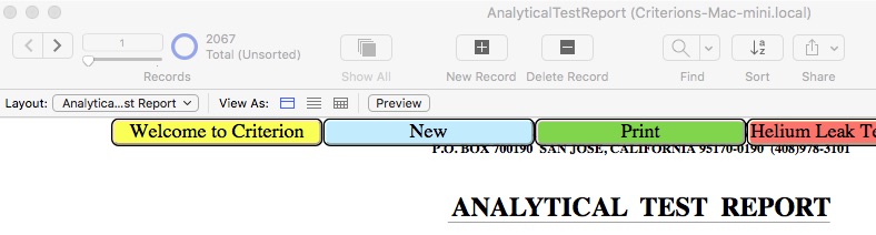

When I click on the Internet hosted files, the local versions open, not the Internet versions, as can be distinguished in the window titles.
I want to shut off the local file access, I only want to access the files via the Internet.
