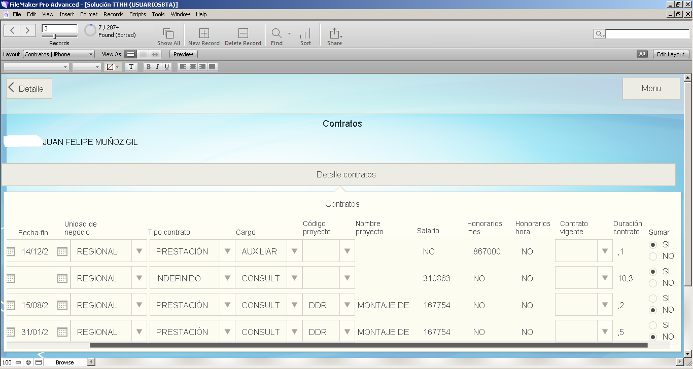

I somehow made a horizontal scroll appear using a popover button and putting a portal inside it:
works amazing in iPhone, allowed me to put 12 fields in a portal and without a problem I can horizontally scroll to all of them
