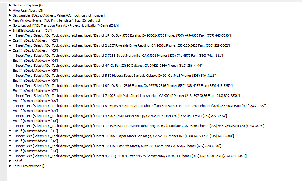

here is an image of how it looks

"doesn't work" is not a good description a problem. What - if anything - actually happens?  Most likely, the value of the variable is not what you think it is (esp. since you say it's "numerical" - numerical values do not have a leading zero).

Insert text requires the field to be on the layout (xxx::district_address_label). Check that it is.
Why use insert text though? Why not use set field?

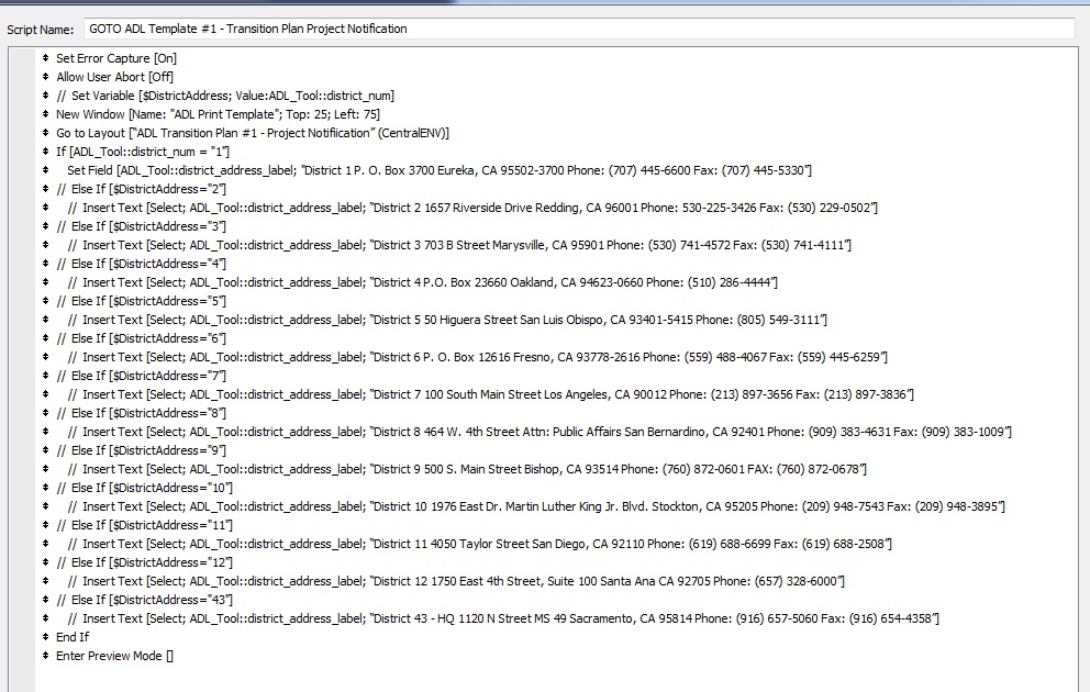

I specified the target field (adl_tool::district_address_label) and set the target field with the "text address I want to insert" in the calculation, but the ayout page with the _district_address_label is still coming out blank. I attached the screenshot with only the 1st district changed. Please see attached and let me know what I'm doing wrong.

Just now, rt916 said:
I like the idea of setting this up as a Set Field step in a script, but how would the calculation look for that?

There is no real difference between using the Case() function and a block of  If - Else if - End If script steps. The logic is the same - and so is the flaw of hardcoding data into the schema. And the reason why one doesn't work is probably the same reason why the other doesn't work either - but without a reproducible example we can only speculate about that.

Check the script step "Go to layout" at the beginning. The layout you selected has a different table source as the fields you are setting. Layout is based on TO called "CentralENV" while you are setting field of TO called "ADL_Tool".
Isn't that the problem?
I am agreed with you. the reason why I use Case() is that it just simplifies the script and make it shorter so debugging is easier.
And again, Agreed, we need to see the file and play around it to have a better understanding of the situation.
CentralENV and ADL_Tool are related TO's, and all the other fields that I reference populate fine. Maybe I need to populate the district_address_block in the ADL_Tool TO first in the script step, then open the layout ADL_Print_Template later in the script?
