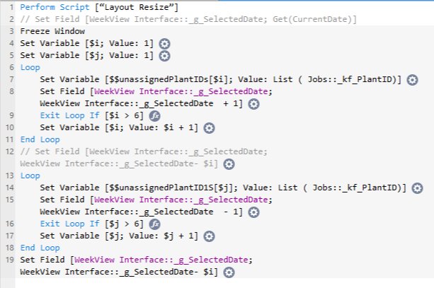

Comment,
I have attached a screenshot of the script in question.
As I said going forward in days via your script is a pearler and works without flaw. Just cannot seem to get it to go backwards in days to show the past.
As you can see I have imitated your script added the variable $j (I used J as it was the next after i which you used) and created a Global variable same as you did however just threw a 1 before the final letter to give it a differentname obviously and changed the Weekview Interface _g_selectedDate to -1 instead of +1 (my thinking is this would go backwards in dates not forwards.
The only thing I did not alter (or add in was the last  line (line 19) i moved your code to the end and so did not perform that after the first loop. ( i did however try with it replicated although that did not work either)
maybe I am not fully understanding the script although I think I do.
Cheers
 I think you're making this more complicated that necessary. If you want to show 6 days back and 6 days forward, start with $i being -6  and increment it by 1 until it becomes 6. You can reuse the same variable name, with negative and positive repetition numbers.
For simplicity, start with gDate being -6 too, and at the end set it back by $i. Or define another variable to remember its original value and use it to restore it at the end.
Got it. I didn't realise that the variable could start with a minus and it would still work.
