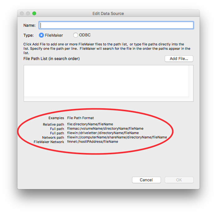

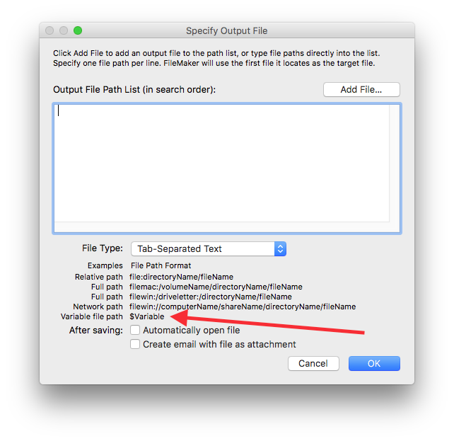

You still haven't clarified which version you're using. In any case, support for variables in external data source is a new feature of FileMaker Pro version 16.
In previous versions, you cannot use variables when defining a data source. This is mentioned in the help in at least two places:
Creating file paths
Editing external FileMaker data sources
You could have also seen the difference between the hints listed in the Edit Data Source window:
compared to those listed in (for example) in the Specify Output file dialog of the Export Records script step:
