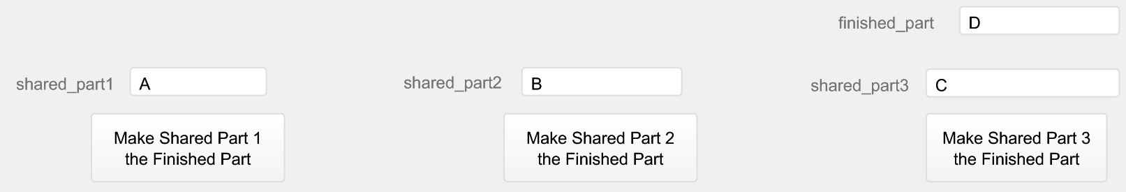

Noobs here.  I am looking for some assistance that when I select a record on a form I am taken to that record.  Example below.
I am taking this simplified hypothetical example in the parts table with columns: Finished, Shared1, Shared2, Shared3
 Row 1 values: A, B, C, D
Row 2  values: B, A, C, D
When Row 1 loads in the layout you sent, say that A appears on the upper right box.  Therefore B,C, D load in the bottom in red
Desired behavior: when B is then clicked, you want it to replace A in the upper right box and have A, C, D appear in the bottom in red.
It would help if you used real names for your fields and real data in your example.
Not completely clear what you've got going there, but based on your first statement "when I select a record on a form I am taken to that record"...
You could create a script like:
Enter Find Mode
Set Field[ finished part ; Get(ScriptParameter) ]
Perform Find
You would then call this script with buttons -- the fields can be defined as buttons if desired -- and in the button setup you specify the field's value as the parameter.
