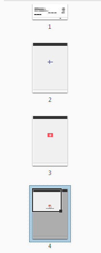

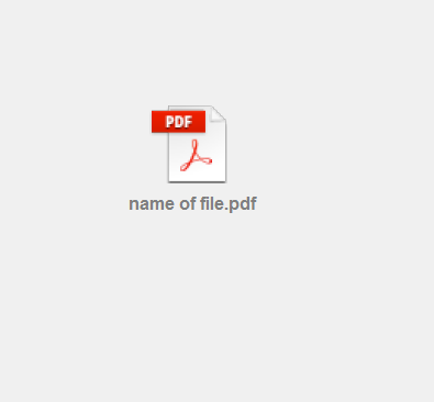

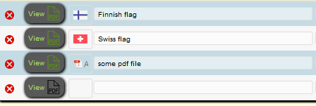

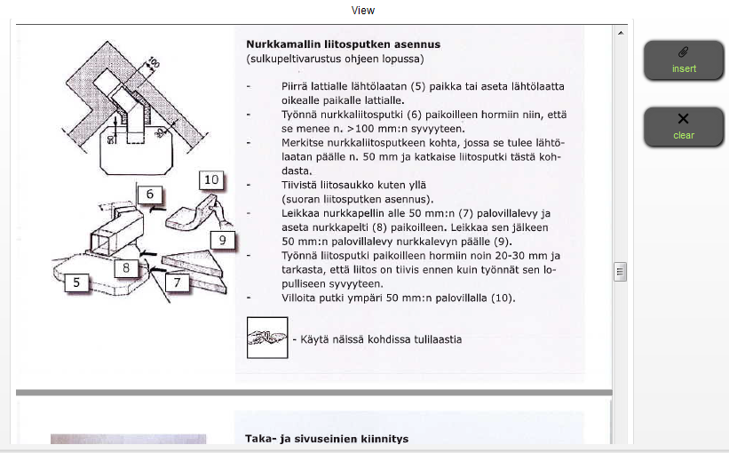

I'm trying to attach some files (from a container) to an invoice. attach1.png.5593d2b6c52d59bb1e3add2342697301.pngThe invoice turns into a pdf file just fine and the png files are attached to it OK. attach3.png.71f09e484dfb91d1459fbde79e31c3c7.pngThe pre-view of the pdf file looks fineattach4.png.485173832e45d8c1971db54b6d025754.png, but can't attach it to the main pdf fileattach2.png.92ca67e8e2a05ccdbe35a624f6963638.png. - Any suggestiones?
You cannot append an existing PDF to a FileMaker created PDF.
You CAN append to an existing PDF that you export from a container.
