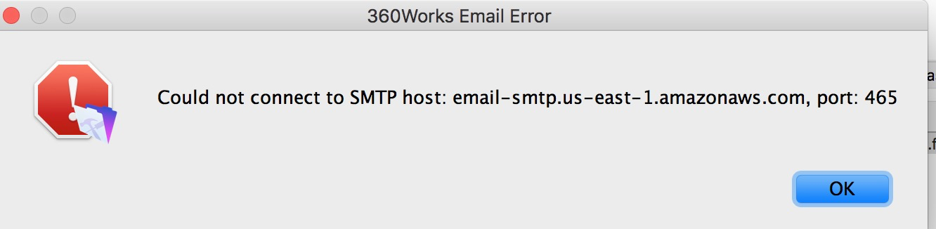

I am seeing EXCACTLY the same same issue  with V2 of  plug in. Ir worked fine until I Upgraded to High Sierra. The connect step fails
Emailasterror returns (after a 30 second wait)"
Could not connect to SMTP host: email-smtp.us-east-1.amazonaws.com, port: 465
Note the FM send mail step works fine with the same credentials, but the port  is 587,   but fails (after about 30 secs) If I set it 465  Fm error 1506
