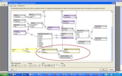

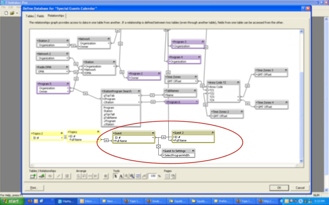

I think I want to use the cartesian join, but I tried that and I am not sure where to relate that to and from and what fields. I tried different variations and none worked.
Thanks and God Bess!
David
Ps. Here is a picture of what my relationship with the certesian looks like.
Ok... I am dumb-founded. I played with it a tad bit more and found that I had to have a self-join relationship and then found it worked with a cartesian, but before that it didn't work.
Why would that be?
Thanks and God Bless!
David
Ok, thank you. I've figured it out. You must use the actual table occurrence that is related to the table you are running the lookup from. DUH! Ok, sorry for wasting your time. It works!
