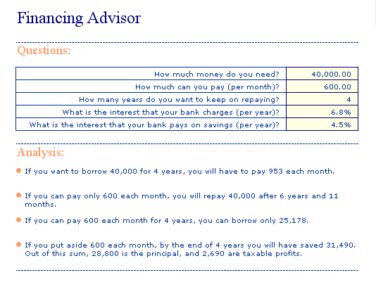

February 23, 200719 yr Hmmm... I have C selected, and I modify B - and I see A getting adjusted. I don't think you can achieve what I think you are trying to achieve, for the reasons explained in your first post. I actually did something like this a long time ago, but I chose a different approach altogether (sceenshot attached).
