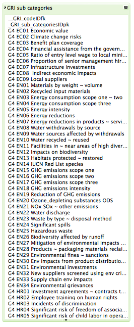

I will attach a few images that will hopefully clarify what I am working with.

The 6 main categories, with the subsequent 91 sub-categories come from the GRI.
The relationships window image gives an overall example of the ideas I have been working with.
The FMP_EC01 image is an example of one of the 91 sub-categories with its indicators requiring data entry.
The sub_categories image shows an incomplete list of the 91 sub-categories to give an idea.

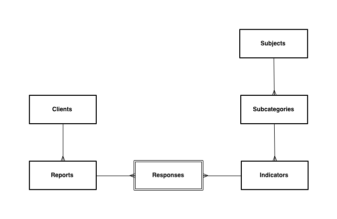

Based on what I understood so far, I believe you need to have a structure similar to this:
erd.png.6653182dfc1f71bbf9925685f2f3aea0
Please note:
The Indicators table contains all indicators, in all categories and sub-categories - and every indicator (question) is a separate record. In other words: if you have 91 sub-categories, with say 10 indicators on average per category, then there will be 910 records in the Indicators table;
Likewise, there will be 91 records in the Subcategories table - not 91 fields as shown in your graph;
This is an ERD: your relationships graph will end up looking more complex than this;
Here we deal only with your data model. You have an additional issue of how to build the user interface so that you can (for example) view all questions in sub-category X and enter the current report's responses for them. However, this complexity should not have any influence on how your data is structured.

To give you an idea how to create/display responses against a grid of questions, I suggest you look at http://fmforums.com/topic/98488-show-a-portal-of-potential-entries-not-yet-created-based-on-dates/#comment-447756 and http://fmforums.com/topic/98863-personnel-training-and-completion-dates/#comment-449625
Thank you! As I have continued to work on this I have come to a similar diagram.
I have been experimenting with 6 tabs for the main categories/subjects on the client_indicator/response layout. Each tab has, for experimental purposes, 9 slides with portals related to the sub-categories with the respective indicator fields showing.
What do you think?

I think you only need one portal. You may find it convenient to use buttons (fake tabs) or even a real tab control object to control what the portal shows, by filtering the portal or the underlying relationship. But by placing multiple portals inside multiple panels you would sentence yourself to having to replicate any design change 54 times.
Please note:
I have a table called GRI codes that has all the 91 records of the 91 sub-categories. I use the Global Reporting Initiative (GRI) codes to standardise reporting to a globally accepted practice. If I put all the Indicators in one table (yes, indeed hundreds of them), I will need to identify which ones are associated with respective GRI codes (the 91). Is there any danger in adding the GRI prefix, for example EN01, to field names related to the sub-categories eg EN01? I note in a previous comment you mentioned this was not advisable.
My lack of experience with FMP presents a road block in that I do not know how to link the GRI codes table with its 91 records to the Indicators table. I have the relationships in place but I don't know how to display the required fields for entry. I have experimented with setting up the tables as suggested, although for now I have kept Indicators represented by the 2 tables EN01 GRI indicators and Indicator questions. I can bring all together into the Indicators table once I am sure that is the best option. Do I need to run scripts or adjust field behaviours? I have tried a few but to no avail, yet. There are issues to do with page layouts for data entry as mentioned, but the architecture is the first issue, then onto building. I have added a few images to provide some context to the kind of data requiring entry.

GRI EC01 shows a layout that indicator. Is it possible make a layout that would display those particular indicators each time, related to a client?
EN01 Indicator questions shows a range of questions associated with EN01 that are used to assess sustainability.
EN01 indicators shows the GRI indicators for EN01. This one is tricky as it has multiple entries for easc field, roughly displayed in Raw materials used. Each entry must also be qualified with External or Internally purchased or sourced and if a renewable material or not. The number of entries required will vary with each client.

I am afraid we're still not talking about the same thing. If you ever intend to summarize your reports, you must have a separate record for each answer. And, accordingly, you must also have a separate record for each question. Your RG screenshot shows a field per question - and what seems to be an attempt to create a separate table for each category.
Before pushing you further on this path, I should also warn you that this is not going to be simple, esp. if your questions do not follow a uniform format (e.g. some require a numerical answer, some a choice from a value list, and some expect text). If you do not intend to summarize the answers, then making just one huge questionnaire, where every question is a field, would be much easier. In such case, you would only need a table of Reports (with approximately 1,000 fields) related to Clients. But then the only thing you would be able to do with the collected data would be to print it (in some arrangement or other).
P.S. If you're attaching images, please make them PNG or GIF or JPG.
I will want to summarise reports, so separate records for each answer is necessary. The seemingly attempt to create seperate tables for categories was more of an attempt to display the kinds of questions/data I am dealing with, and in the case of the indicators, not committing all indicators to one table until I am confident of how to work with and display the data.
