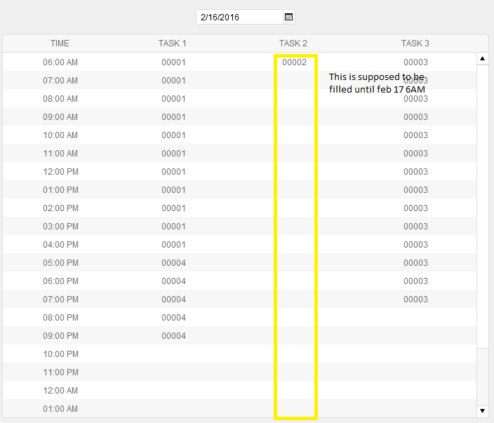

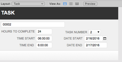

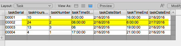

I have a previous post here about this but i deleted it because of confusion. The calculation @comment provide me is working but i have a problem, I am not sure if its on relationship or calculation field of the date and time. I attach the example data. In task layout record 2 as you see the hours to complete is 24 so when i start at 6:AM of feb 16 it suppose to end at 6:AM feb 17. In View layout it should show but it is not appearing when i select the date of Feb 16. I also notice when i add record that exceeds at 12:AM it is not showing.

Here is the screenshot

it's because your time end (even though on a different date) is not greater than 6am, so the relationship from the 7am and later timeslots is not valid.
You'd be better off using a timestamp field for the relationship instead of separate date and time fields.  The end-time field does not know it belongs to the next day...
What will happen is that i will create start timestamp and end timestamp is that correct?
How about the relationship on the Date global fields?
you wouldn't need a relationship on the date or time fields, just one on a new timestamp field in the Time table (that is a combination of the global date and the time field)
and you'll need new timestamps field in Tasks, one for start and one for end and base the relationship on these.
