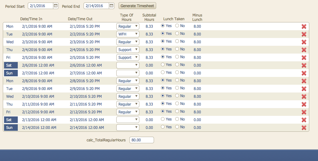

Consider a standard timesheet application with a parent "timesheet" table and a related "timesheet details" table connected with a one-to-many relationship. On a layout based on the timesheet table I have a portal that outlines the details for a two week pay period. One of the elements on the timesheet details is what type of entry is it (i.e. regular hours, support hours, etc.). I would like to be able to summarize the hours of each of those entries on the timesheet layout. I have been able to create a calculated field that does sum the total hours well and I thought if I made the calculation something like this:
If ( Timesheet_Details::Type = "Regular" ; Sum ( Timesheet_Details::Hours_With_Lunch ))
It would only summarize only those timesheet details that had "Regular" in the "Type" field. Alas it does not work. Not sure how to approach this. I tried a summary calculation but it does not allow for summarizing specific data (seems all or nothing).
Would appreciate some direction on this. Ideally I'd have three calculations on the timesheet layout for "Regular" hours, "Support" hours (which are calculated differently and "WFH" hours.

For display, I would suggest you define a summary field in the "details' table as total of hours, and place it on the layout of the parent table within a one-row portal, filtered to show only "regular" records from the child table. Duplicate twice, and change the portals filtering to the other types.
Wow...both excellent suggestions. I'm not really great with the ExecuteSQL function yet (I'm practicing). I find the portal approach very fascinating too and I'll probably try that first (very creative). Thank you both for your suggestions
John
The portal suggestion works excellent. I'm curious though....what would be the procedure to attached to the "Type" field to refresh the summary fields in the portals. I calculates well if I leave the layout and return but I'd like to add a script trigger to the type field to update the calculations if it changes
