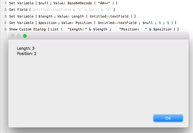

I'm way late to the thread here, but another way to make a (perfectly valid!) null character in FileMaker is Base64Decode ( "AA==" ). While this is a perfectly valid character both in UTF-8 and in Unicode more generally, it is disappointing that it doesn't get escaped in export formats like XML where it is not.
Edited by jbante

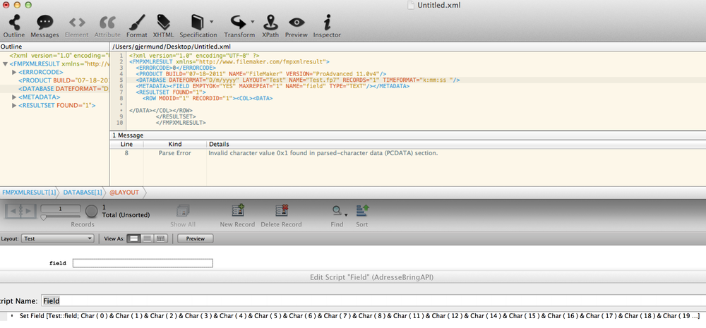

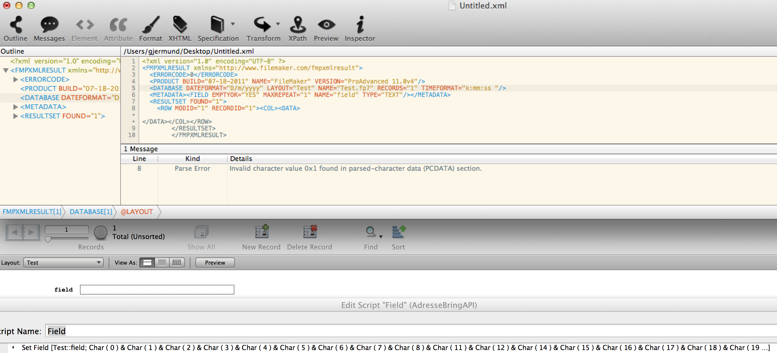

The application used to open the output XML is Xmplify, but tidy, xmlstartler and xsltproc all agree this is improper XML.
This is the closest I have come to a solution( in this case the numbers are kept as a debugging tool to see if it's possible to find the source ):
( Too bad it locks and returns errors when users are in that field )

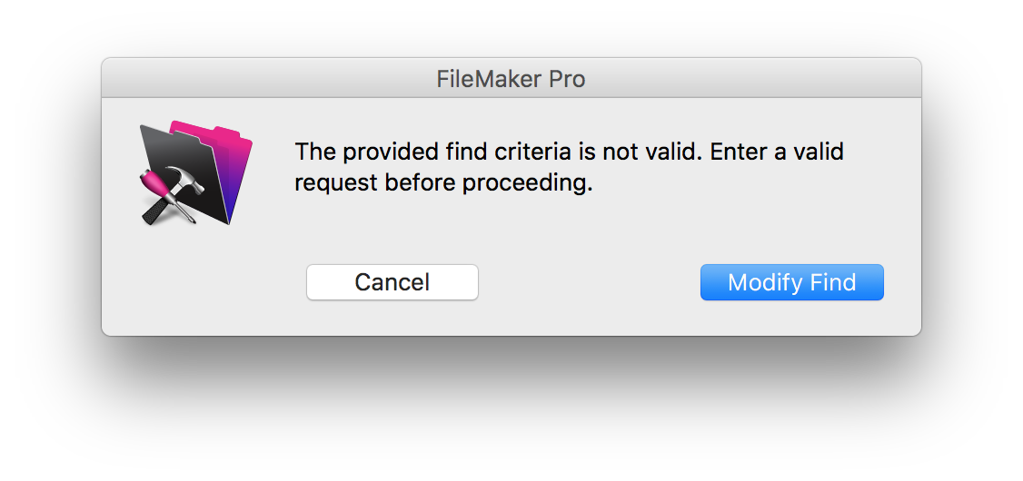

0x00 is an invalid search criteria when copied from a field in browse mode and pasted into the same field in find mode

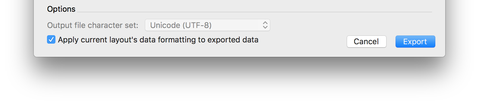

[ Solved ] When Checking the box "Apply current layout's data formatting to exported data" for formatting the issue of 0x00 is no longer present for XML exports.

A solution to the original problem! Huzzah! And I really like a more thorough enumeration of the difficulties getting FileMaker to work with the null character. However, null-terminated strings are generally avoided whenever possible these days. Despite the other awkward handling of the null character, FileMaker is probably not using null-terminated strings under the hood, either in the calculation engine or in field storage:
Let ( [
    _null = Base64Decode ( "AA==" ) ;
    _string = "a" & _null & "a"
    Position ( _string ; _null ; 1 ; 1 )    // = 2
Edited by jbante

Using the check box for formatting does not fix the problem.
The problem occurs once in a while ; I add the character and that's another one down.
Tell us something we don't know...
I am not sure what you mean by that.
