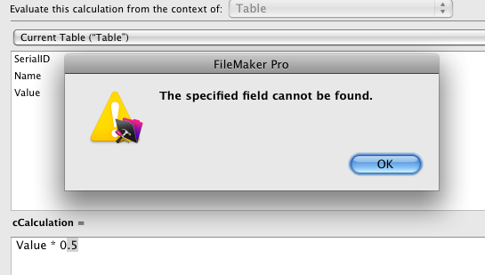

That is grossly incorrect: the decimal separator can be either a dot or a comma (or even another character), depending on your system settings.
https://en.wikipedia.org/wiki/Decimal_mark
If your file expects a comma as the decimal separator - either because it was created on a system using comma as the decimal separator, or opened on such system and set to use the current system settings in File Options - then you must use a comma as the decimal separator in a calculation. Otherwise you will get a syntax error, and you won't be able to close the calculation window:
se.png.e2c47f1251b7f89d772298d5f7fee8b9.
In which is true if you are stuck with someone else's solution, however what I'm saying is a general code of conduct / preferred global approach to avoid errors when copy / pasting calculations and scripts between solutions.
By saying that I say I'm appreciating and easier life running one standard opposed to keeping track of which solution uses what standard.
It's much easier, at least for me. to have programming done with the mathematical language using "." as decimal separator in all calculations regardless of which solution I'm working on, and leaving all kinds of weird language/standards to the layouts. Like formatting whatever according to the language at hand. Such an approach is much more translateable to whatever. Especially when you also look at the thousand separator; in which could be comma, period, space, genetive symbol, single quote, and a couple of others, while decimal separator usually is space, comma, or period, and other region / language specific oddities; in which is non functional and 100% cosmetic.

I will be not dragged into this, as it has nothing to do with OP's issue.
OP's file is obviously using a comma as the decimal separator. They are not "stuck with someone else's solution". Apparently they are Swedish, their system is Swedish and presumably they prefer to conform to their own standard. That's a perfectly legitimate choice. There is no "general code of conduct / preferred global approach" with regard to decimal/thousands separators, as there is no general standard regarding date formats.
Most importantly, changing the system to use decimal dot will not solve their problem.
