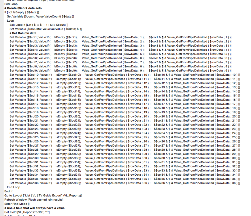

It seems that the way I have implemented Virtual Lists bogs down on large ( 10k+ ) record sets. Building the $$data variable works fast enough ( LAN, 7 seconds for 2k records to 13s for 3k ), but then building the $$col variables takes what seems like exponentially more time ( 11 seconds for 1K records, then 41 seconds for 2K records, 82s for 3K...
Is there a way to improve the performance?

What is the "Value_GetFromPipeDelimited" function do? Or more accurately, what is the calc?
Also, what is the use-case for setting 36 columns of variables? Not arguing for or against, curious what you are doing with it. :)
It's a CF to retrieve data from a data row that's pipe delimited:
// Retrieves the value from a pipe delimited data set at postion X
// Useful for parsing FQL query that uses the | as the delimiter
// Note - Requires a final pipe on the data set
Let( [
    Begin = Position(Data; "|"; 1; Number - 1) + 1;
    End = Position(Data; "|"; 1 ; Number) - Begin
Middle(Data; begin;  end))
And the use case is that I then need to export that set as a .csv for ingestion into a 3rd party system - I've got no control over the final format, it just needs to be 36 columns in the right order....
