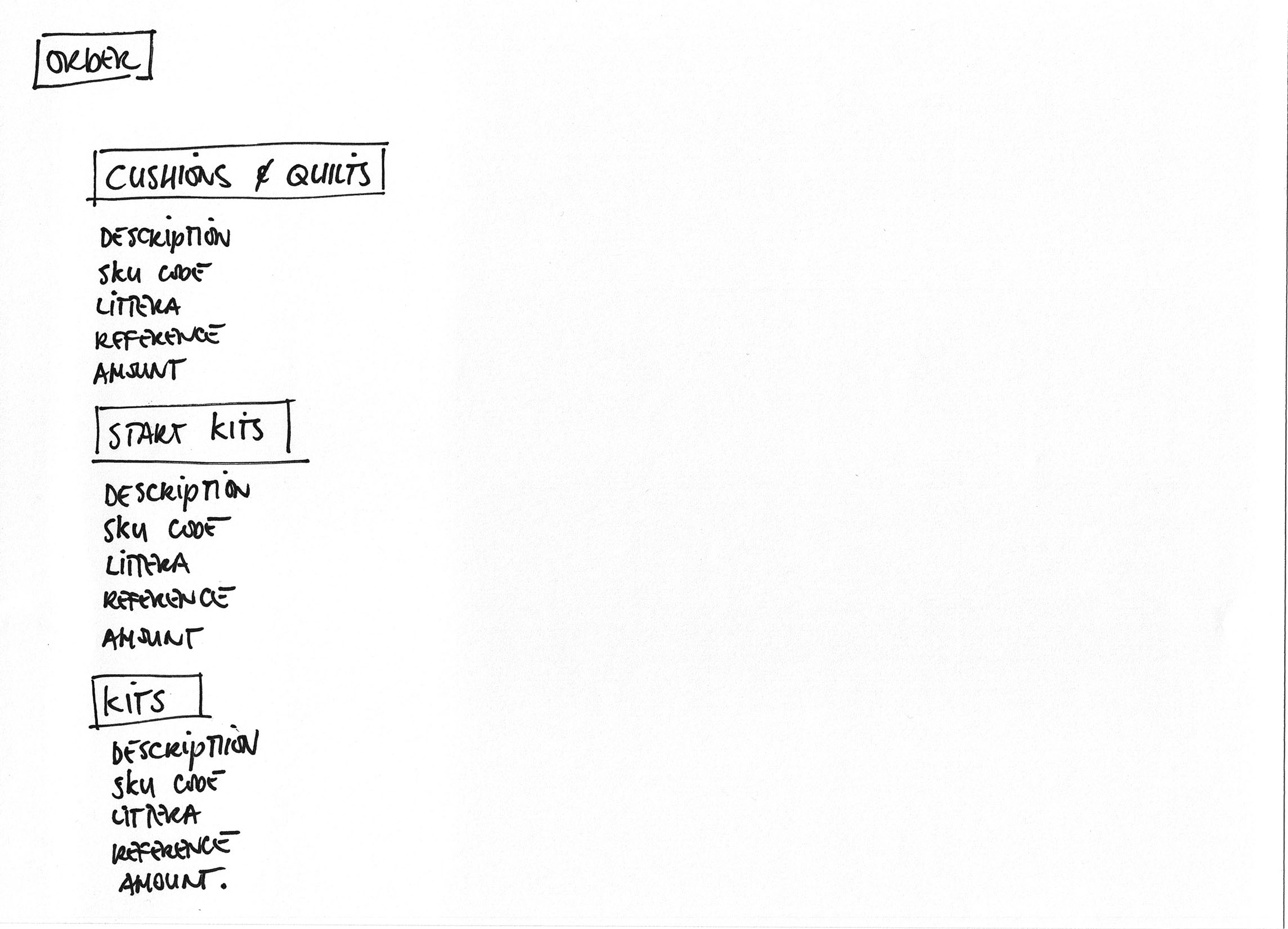

I'm trying to make a simple database to simplify orders we regularly have to place. As you can see in the file, I've created 3 tables. (more to come) All three tables have the same titled fields. In the field: 'Amount' I can fill in how many items I would like to order.
On the table 'order' I only would like to see the items I'm about to order. (when I put a value in the 'amount' field, it should be projected to this page) I do not need the other items on this page. (They are not a part of that order) See the scan for a quick sketch of the layout of the 'order' lay out.
When (for example) I do not need anything from the layout 'kits', this section should not be seen on the 'order' layout.
These three tables should be rolled into one Products table. You can use a Type field to distinguish between the three types of products.
OTOH, you need to add a line items table to join between Orders and Products - and the "Amount" field (i.e. Quantity) needs to be in this table.
See a basic demo of an invoice solution here:
http://fmforums.com/topic/63425-auto-fill-one-field-with-text-from-two-fields/#comment-300150
