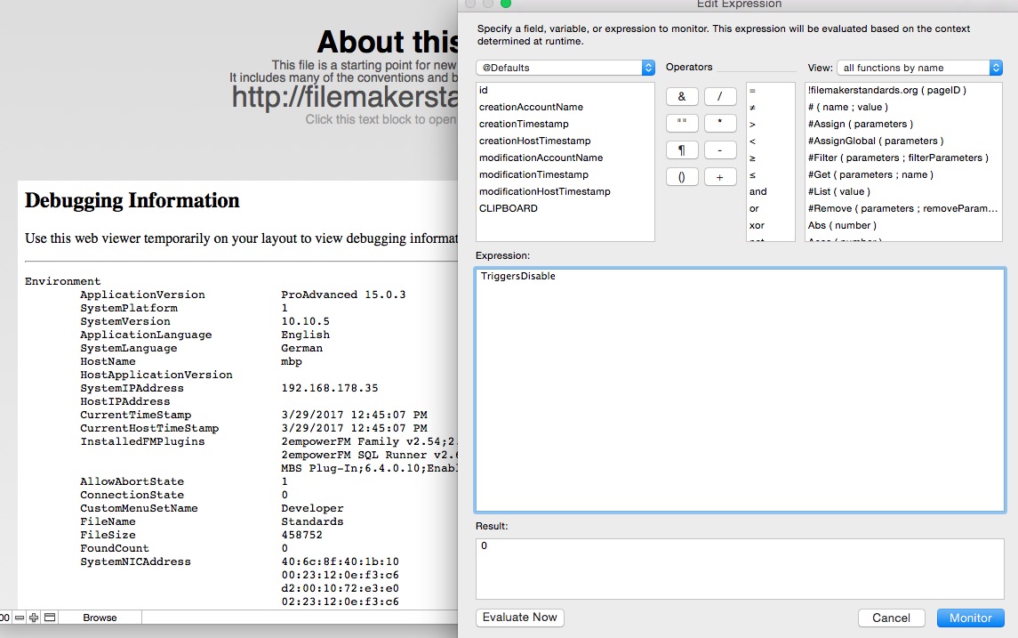

March 25, 20179 yr Hi, I'm aksing myself how I could make the trigger functionality of the fmstandards package work. When I call the CF TriggersAreActive, I get True(1) as a result (in the Data Viewer or inside a Set Variable script step). When I call TriggersDisable and then TriggersAreActive again, I still get True(1), so Triggers are still active. I could simply use a $$ variable to save the trigger state, but I don't want to, because that can lead to problems using subscripts. What am I missing? Thanks a lot for your help, Gary

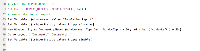

March 26, 20179 yr I use those functions in my solutions. I usually just use a script vairable, $triggerStatus, and use a set variable step to call the custom functions. Set Variable $triggerStatus = TriggersDisable, and $triggerStatus = TriggersEnable. Just remember to use the functions before any halt script steps or where necessary in any if statements.

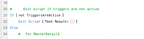

March 26, 20179 yr Here are two examples of using the FMStandards scheme. One is a script that runs on the script trigger OnRecordLoad. It runs if TriggersAreActive, but exits if not TriggersAreActive. The other is part of a script that creates a new window, but I do not wish the OnRecordLoad script to run; so I disable the triggers before opening the new window, and then re-enable the triggers after going to my target layout.
March 27, 20179 yr On 3/24/2017 at 11:17 PM, gczychi said: When I call the CF TriggersAreActive, I get True(1) as a result (in the Data Viewer or inside a Set Variable script step). When I call TriggersDisable and then TriggersAreActive again, I still get True(1), so Triggers are still active. I could simply use a $$ variable to save the trigger state, but I don't want to, because that can lead to problems using subscripts. Others have commented on the usage of the functions, so I won't repeat that. The behavior of the Triggers* functions you describe sounds like a bug, but I can't reproduce it. Can you post the script where you saw that behavior?
March 29, 20179 yr Author Thanks, Jeremy, 1) Out-of-the-box Standards.fmp12 file from Standards 2) Data Viewer «TriggersAreActive»; result 1 3) Data Viewer «TriggersDisable»; result 0 (see screen shot) 4) Data Viewer «TriggersAreActive»; result 1 Gary
March 29, 20179 yr TriggersDisable is designed to be called by a script. It won't disable triggers without a script running to help developers avoid shooting themselves in the foot. What you're seeing in the Data Viewer is how it's designed to work.
