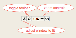

To address the loss of the bottom toolbar during development, I have created a small toolbar which I am putting on every layout with a hide condition if [ not "Full Access" ]
As a result of reading this thread, I think I will be adding  additional buttons/segments to include "Show/Hide menu bar[toggle]" and to access layout Mode

I have a similar problem as I mentioned in another thread. Mine's even worse, though. I have FileMaker running digital signs. By default I turn off all toolbars and menus. In FM 16 I would then just hit the button in the bottom toolbar to bring the menus back and switch to a standard menu when I needed to work on the file. Can't do that anymore! I also REGULARLY used the menu in the bottom toolbar to switch between modes. Can't do that anymore either. It is really a pain now. I am not liking 16 very much. If it wasn't for the ability to create PDFs from the server I wouldn't even be considering switching. But so far that seems to be irrelevant because I can't get a critical web viewer to render to PDF in 16.
/rant
@Cable, see my latest response to your other post. Bottom line is, keyboard shortcuts are your friend.
B for browse, L for layout, F for find (OK, U for Preview is a little trickier but still...)
Ctrl-alt-S for Status toolbar
