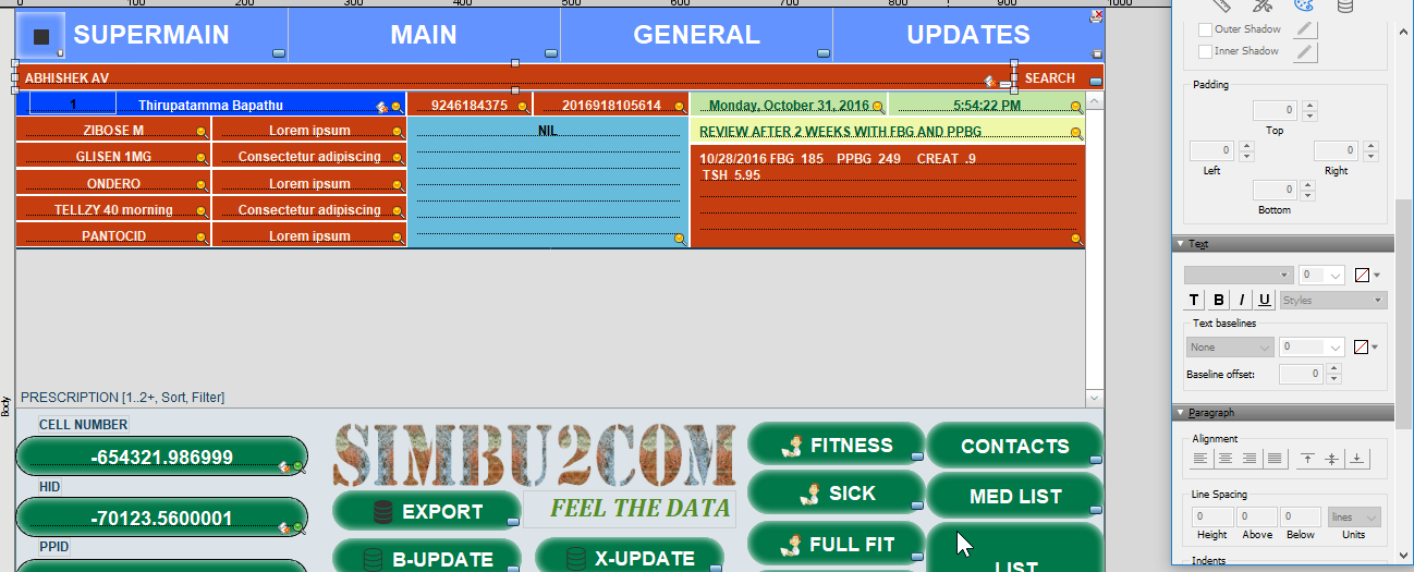

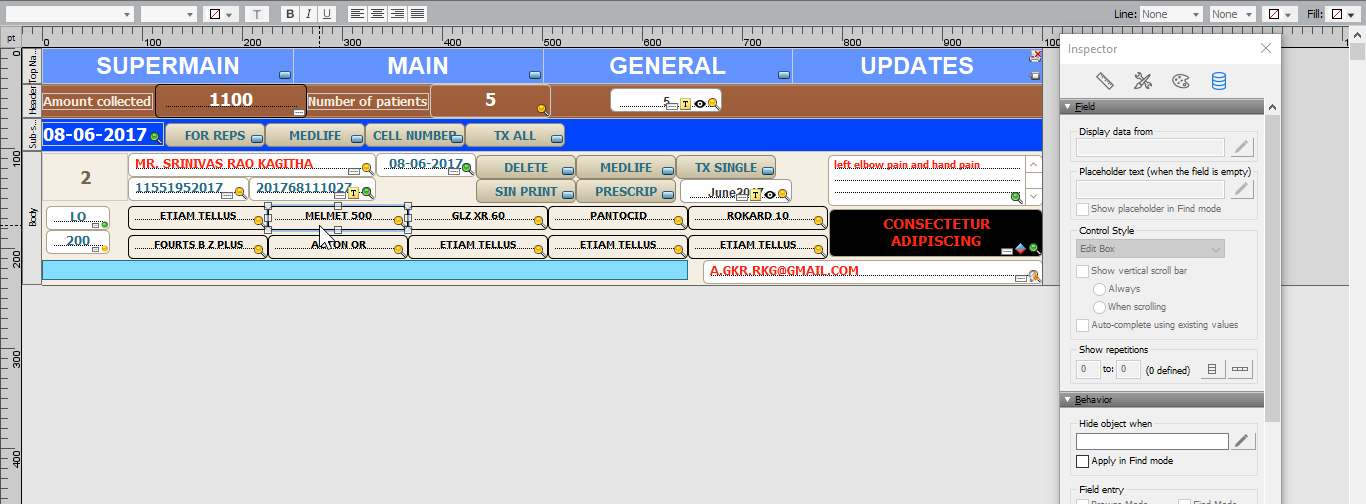

no i am not able to edit the formatting of fields related to other tables and not even able to change edit box drop down vice versa in fm 16 adv i have selected the field u can see formatting bar locked - tables are related and not global fields reported to filemaker inc want to clarify - hope i am clear from here 59397ca4c4e95_2017-06-0822_04_36-AboutFileMakerProAdvanced....png.5b5a4fa5ad700330af586a7b98614e4b.png59397bf9a80e8_2017-06-0822_00_38-SIMBU2COM.thumb.png.57e5cb3eda1901242727635f5b047a34.png
Is that field formatted as a button? Look at the Layout Object List and see if it is. If it is, you need to select the field, not the group. ( Making a field a button automatically creates a button object that is grouped with the field ).
What Josh was asking to do was to look at the new Object Inspector window while you have that field selected.  From the menu: View > Layout Objects

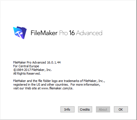

hello Gopala Krishnam Raju,
Thank you for contacting FileMaker Customer Support. This is a Winsoft version of the software so you will need to speak to them but before you do, we advise that you try changing the theme, as you might be using a theme in FileMaker Pro 15 that is no longer available in 16. Before you change the theme though, be sure to make a backup copy of the database solution first.
If you have any questions, please contact Customer Support on: 0845 603 9100 (United Kingdom) or 01 4073432 (Ireland), Monday-Friday 9:00 a.m. – 5:00 p.m. (excluding holidays)., and reference case number: 170609-000035.

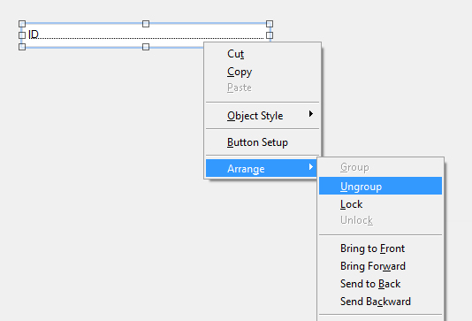

Filemaker 16 got me with this one too if it's what I think it is. I had several fields that were formatted as a button as previously mentioned. In FM15 I could select the field and change the data source and such. In FM16 the options were grayed out and unavailable. What I realized as mentioned was that the field was now grouped. The easiest way I found is to right click the field and choose Arrange > Ungroup.
I do find this annoying as I have to ungroup to make any changes and in doing so I lose my button setup. After the change I have to reformat as a button again. I often use some pretty complex script parameters so I need to be sure to copy them before I ungroup so I can replace them. It's not a big deal but less convenient than previous behavior.
