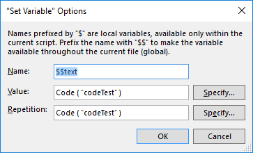

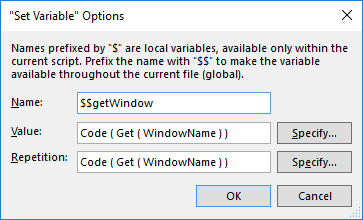

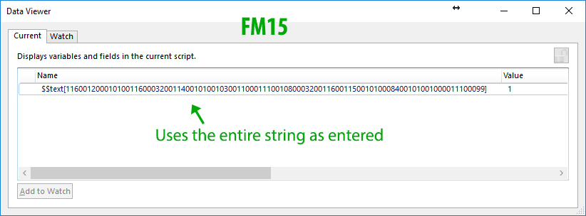

I created a test file and a script that set two variables as shown below. The name of the window is codeTest
text.jpg.2f217eba02e9959721681e374b429a50.jpggetWindowx.jpg.8184b3fd948230930549d4284cc7070a.jpg

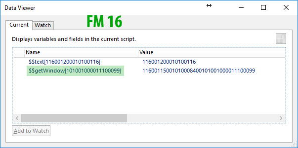

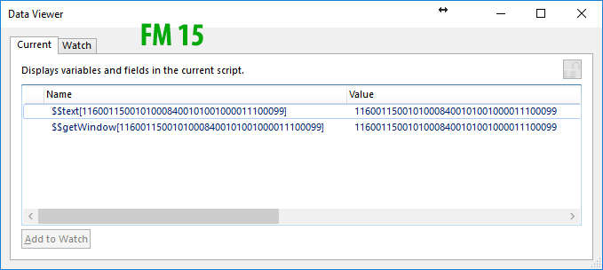

Here are the results in the Data Viewer of both FM15 and FM16
As we can see the Variable repetition result is different in FM16 for code ( Get ( WindowName ) ) and different than the result in the variable value...

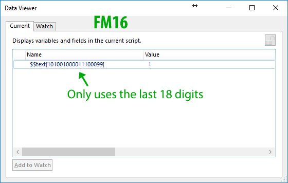

As a follow up. I set a variable $window to Code ( Get ( WindowName ) )  and then entered $window as the variable repetition.
The value of $window shows as 11600115001010008400101001000011100099
but putting $window in the variable repetition shows as 101001000011100099
And as I'm entering this post I just realized that the perameter shows as the last 18 digits of what the value in $window
Well, that seems to be it. The Variable parameter seems to be limited to 18 digits and it uses the last 18.

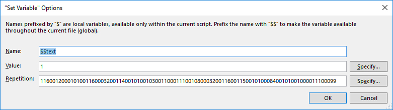

I entered 11600120001010011600032001140010100103001100011100108000320011600115001010008400101001000011100099 as the variable repetition and the result was 101001000011100099 as the repetition
Is this expected behavior?
So here is the issue simplified which had nothing to do with code ( Get ( windowName ) ) after all.
Variable repetitions in FM16 appear to be limited to 18 digits. If more than 18 digits are entered it will use the last 18 digits of the entered string whereas FM 15 and prior did not have this limitation.
