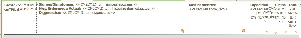

 3. install chevronned text strips (i dunno what you pro's call 'em)  ->     <<Visit::PrescItemName>>,   <<Visit::PrescItemSize>>, etc....    these will look up the data as needed...

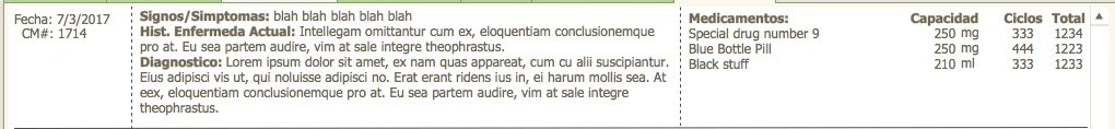

These calc fields are not ONLY used inside the self-related Visit reference portal.  So when one flips to that layout, the portal sees a visible list of all related prescription names & sizes inside the portal...
It's working fine, i think. My primary concern is whether or not running a handful of calculation fields in a portal would/could cause any sort of performance glitch - is that an issue?
here's a snapshot of the double-chevron views:
Here's how it actually plays out..
Side question:  what do the pros call those double-chevron text fields?  (<<table::fieldname>>)

Merge fields.  You can see it in the menu bar in layout mode Insert>Merge Field...
Also as a tip, you can highlight everthing between the first and last chevron and change the font to 1 point, to shrink them up in layout mode for easier viewing.  If you ever need to see which field it is, click on the field, select 12 point.  When your done, click outside the field and Ctrl +Z to undo and return it as it was.
<<LONGTABLENAME::ExtraLongFieldName>> would basically look like   <<LONGName>>    (1 pt. font not available on this forum)
