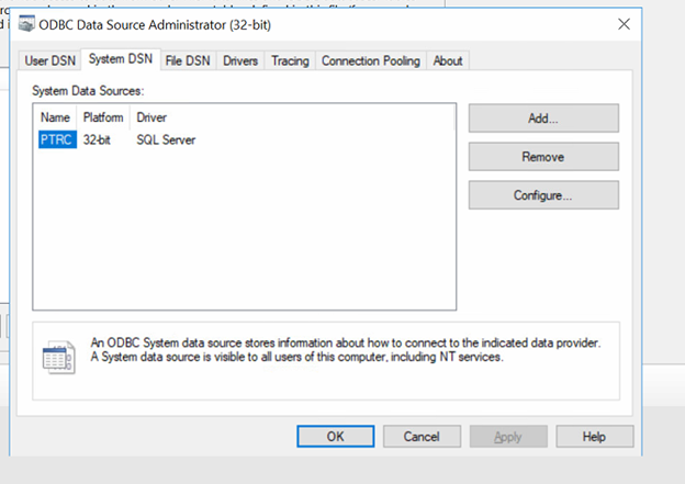

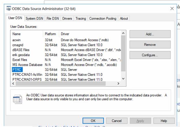

We have a windows 10 desktop with user DSN's and System DSN's specified,
image.png.ed4dc7e4d8dc7bbd59aafafbe3872c62.pngimage.png.873c7d53fa1441313be64f88705c2795.png

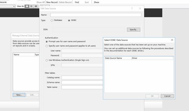

However the Select ODBC Data Source shows no entries?
I have seen older posts saying that a System DSN has to be specified, but we did this and still nothing showing, is this a bug or am I missing a step.

The server I am trying to talk to is a Windows server (not sure of the exact OS) and we can successfully connect using the ODBC drivers (ie in the ODBC settings we test connection and it completes with success. We can also connect using another application, Lotus Approach, using those same ODBC drivers. Someone else told me to try the 64 bit drivers so I will try that later today.
Yes, that’s probably correct! In Windows, if you’re using the 32-bit version of FileMaker Pro 16, you must use a 32-bit ODBC client driver; if you’re using the 64-bit version of FileMaker Pro 16, you must use a 64-bit ODBC client driver. In macOS, you must use a 64-bit ODBCclient driver.
