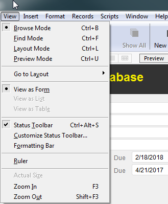

Hello, I have been using FMP for only two weeks, so please excuse my ignorance.
I am using a trial version of FileMaker Pro 17 Advanced (17.0.2.205) on Windows 7
After accidentally deleting my primary layout, I successfully copied it from a backup. However, since then I have not been able to switch to table view. Both the button and the menu command are greyed out. Is there another step that I must do to be able to use the other views? I guess I could try to make a layout that mimics the table view, but I'd prefer to fix what I have broken.
Thank you
Go to Layout mode. Select Layout Setup… from the Layouts menu. In the Views pane, enable Table view.
