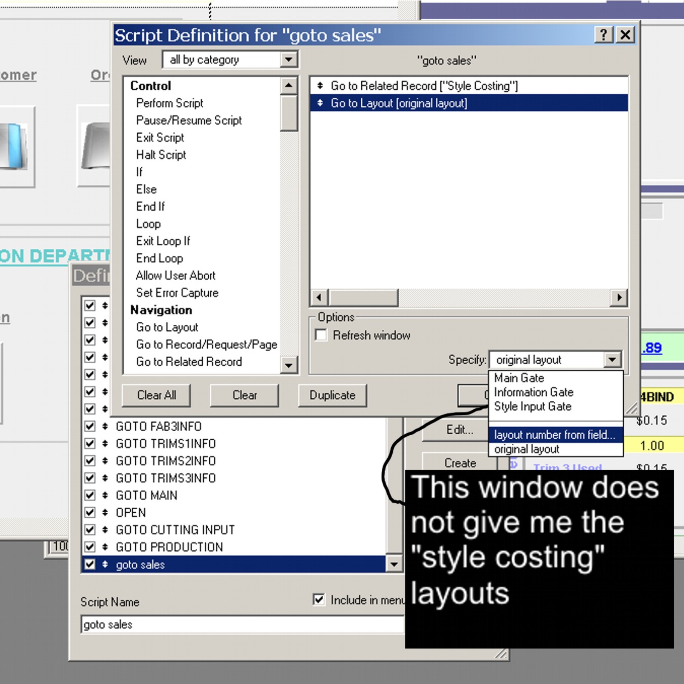

Hello Andy,
I did what you told me to. But on
"Go To Layout [choose the correct layout from the options] "
it doesn't let me specify the specific layout(I mean it doesn't show the layout i want it to go to).
I bet the problem is that he needs to go to a specific layout in the RELATED file.
Ronnie, you will need to create a 2nd script in the related file that has a "goto layout" step. Then in your first script, call your new script in the related file.

Ok, I did that but on the external- because on the goto layout command, I can't specify "Go to Layout[style Costing]
on the specify option, it just give me 5 options:
1-layout 1
2-layout 2
3-layout 3
layout # from field
original layout
It doesn't give me the option for
"style costing"
I just used Style Costing as an example. You will use whichever name is appropriate for the layout you want to display.
I understand that you used style costing for example; and that is where i wish i was at (have style costing: layout #5,or 4 or 3 in my specified option) but I don't have that option: any ways here are the file: Please take a look...

Your TOLAYOUT1 script already has it. Just call that script in your other file, after the Go to Related Record step, using Perform Script, select External, navigate to the file, select it, then select its TOLAYOUT1 script.
thanks a lot smile.gif... it works.... I finally got it....
