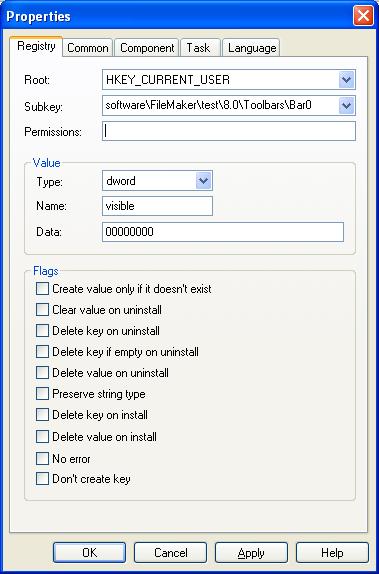

Works fine, but please help me how to implement your first advice. Two days I try to figure out... :P
Is there (on picture) must be checked one or more flags? Or something else...
TIA
Forgot to attach picture
