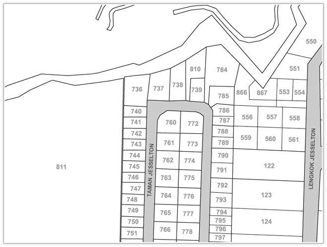

The reason I stated on the subject header 'weblike' is because the best way I can think of presenting this database in a user friendly way would be from a overhead detailed map(sample attached to provide a better idea of what I'm talking about) with the user being able to select whichever property he/she is interested in knowing more details about. I know that there are a few ways to make buttons so that they may select that property such as drawing shapes:circles or squares/retangular or setting the text as a button. However each property comes in different shapes and sizes and thus this is my problem. In other applications, one is able to draw whatever shape they would like and turn that into a button. An example would be on dreamweaver, u can draw any shape n size for a 'hotspot' for users to click on. Is filemaker able to do something like this?

In regards to Prob 1, I know that would be the easiest but before I go ahead I wanted to make sure I have explored all posibilities. I would still prefer to have the entire area be filled(customised shaped buttons) because i'm also trying to figure out how to do rollover buttons. Therefore if i can map the region, it would look nicer as well in my opinion. I'm giving myself a few days to figure out and hoping others may help give some ideas before deciding to go for the text button.

On (Q1) Yeah, I've been tinkering around but i'm stumped. Even if you can create custom shapes, when imported in, it would still be a square and that would overlap with the other shapes. But thanks for trying out though. I appreciate it.

I don't think this can be done in Filemaker natively - custom shapes or not. Any button you create has a permanent position on the layout. For 100 maps, you would need 100 layouts, and a mechanism to determine the correct layout for the current map.
Perhaps it could be done by displaying the maps in a web browser, with the image map coded to call the matching record in Filemaker via AppleScript - but I'm afraid I don't know much about that.

Scan each map in and place indivdual transparent buttons over each lot. Use the map as a menu to direct the user to the record about that lot/block address.
I agree that this is more trouble to draw natively than it is worth. Use the overlay approach, with the sub-division plot map as wallpaper. I do this all the time with forms, with excellent results.

Come to think of it, you could probably save yourself a lot of trouble by using the map as a key, and having the user enter the block number into a field in order to view more information. It seems sort of logical in this case, especially seeing as your maps may all vary in size and shape and as comment points out your likely to need 100 layouts to match your hundred maps --> with the key, you could just have a container holding the map for each section and store lot info in a related table, linked by a primary key and lot number.
I can almost guarrantee you that your users won't mind - the only person who would mind is you if you tried the buttons - because of the amount of time you would have to spend, only to perhaps shorten your users movements by 1 second. Do a cost / benefit.
Further think about the time it will take you to maintain in the future - you as the developer will have to sit there for hours on end adding new layouts, and maintaining things. And have a look at normal industry sites, they ask you to enter a lot# to enquire about.
