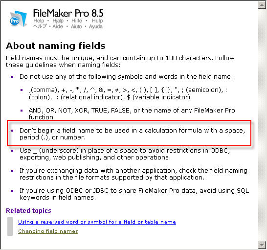

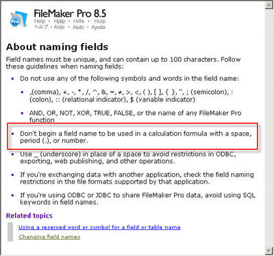

Taken from the help section of FileMaker in regards to naming fields...
It is not good practice to name fields leading off with a number. You should considering revising it to months_3, months_6, etc.
Thank you for the tip!
How Do I change the Field names so that they do not start with a number? Is there a way to do a find and replace that will rename my fields and change my formulas that contain those fields?
