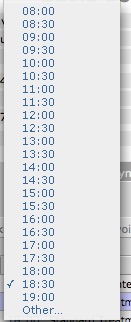

March 10, 200719 yr Hi All, I have two databases, within one is a value list that provides preset timings for the start of a booking in the format 10:00 etc. This just fixes the start of the booking at half hour intervals. When i try and link to this value list from the second database, the link is good but the list has added and extra :00 ( i guess seconds indication) to the value list. ie i now get 10:00:00. I have tried all the different formatting options which only seem to affect the data after you have chosen the relevant option from the value list. How do i change the formatting when displaying the value list? It's bugging me but i'm sure it's something simple! Any ideas? note: The value list in the original database display perfectly as 10:00 etc

March 17, 200719 yr Author Hi Martha, Thanx for that infor and sorry for the delayed reply, it's been a very busy week and this is just a hobby for me rather than an occupation! I'm slightly confused by your answer as i figured that it was simply a formatting issue and i'm surprised that i have to perform any calculations, simply to display the same value list. I have enclosed two screen snapshots, just to illustrate the problem. Image 1 is the original value list in my first database, image 2 shows the same value list in the linked database. Just doesnt seem to make sense that the values display differently, when it's the same list. The linked database is a ready made one that i have adapted but even the originator of that can't suss out what's going on! Any ideas would be very greatfully received. Many Thanx Mark B

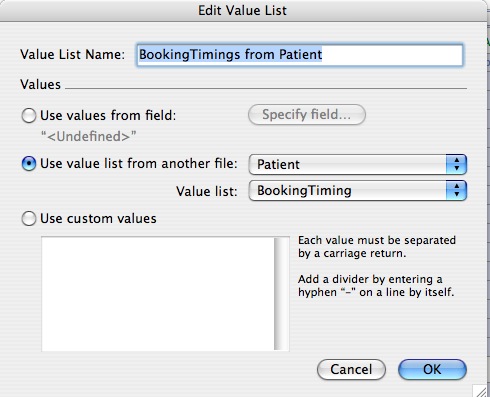

March 17, 200719 yr Author Hi Al, Are both fields formatted the same? Again, I assume you clicked on Format>Time>"Leave data formatted as entered" OR Format>Time>Format As>HH:MM>Symbol> . Yes both fields have been formatted the same but in any case this only affects the display of the field AFTER you have selected a value from the value list. Are both fields defined as Time fields? Yes both are formatted as time fields. I have enclosed another screen shot that shows how the second value list is created, from the original list. Like i say and as the previous shost show, it is the same values, just with :00 added on to the end of each value. There is actually just one field, but it appears in two different places in two different databases. All the relationships are good and the data moves fine in either direction, it's purely this change in value list that's causing problem.
March 17, 200719 yr Hi Mark, If you click into the Source Field of the Value List, I think you will see the problem. I hope the attached file will help to clarify what is going on. What ever formatting the original field has, will be kept in the value list. The answer to your problem is to create a Hard Coded Value list of times, and use that instead. HTH Lee TimeEntry.fp7.zip Edited March 17, 200719 yr by Guest

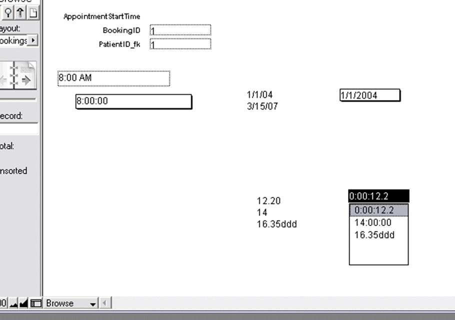

March 19, 200719 yr Well, it kinda of makes sense to me - because FM says: If the value list you're defining contains dates, make sure the values contain four-digit years such as 6/29/2004 instead of 6/29/04. During data entry, a date field formatted to display a value list containing two-digit year dates will convert them into four-digit years as described in Conversion of dates with two-digit years. It converts date displays (on value lists, even Custom) to display proper 4-digit years. If you change the fields to text, FM won't attempt to fix the value list (make it proper time) before it displays it for you. UPDATE: And just for clarification, it is displaying the seconds for me as well. Since this is a Custom Value List, you are assuming (fairly logically) that it should DISPLAY your text-time but FM wants to make it true time; just as it displays dates as true dates (within value lists), ie, it matches the legitimate data-type. LaRetta :wink2: Edited March 19, 200719 yr by Guest Added Update
March 19, 200719 yr Yes, but this doesn't happen with times. If you make a CUSTOM value list of say "1¶2¶3" and attach it to a time field, it will display as is (at least that's what I see).
March 19, 200719 yr FileMaker doesn't auto-complete numbers but it does on partially entered times or dates. Custom value lists on both appear to be consistent in this regard. Oh. My point. Numbers entered in a custom value list as: 12.30¶14¶16.22 ddd, attached to a time field displays in the value list as time as: 0:00:12.3 14:00:00 16.22 ddd There is a reference in Help about how FM will attempt to match the data type - I think something about how it indexes... Edited March 19, 200719 yr by Guest Finally got to my point & added sentence.
March 19, 200719 yr :shocked: Does it take into account system formats for determining the display of Custom time or date? Edited March 19, 200719 yr by Guest

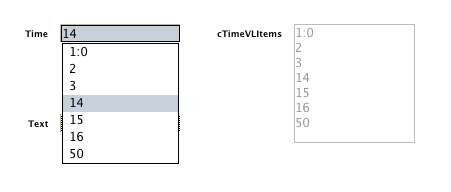

March 19, 200719 yr Are you setting your ValueListItems() calculation to result of time or text ? What is funny, is that I change my calculation (ValueListItems) to text and attach that same value list to it instead, it displays as yours does! It says FM will attempt to match the value to the FIELD to perform its task, ie, "FileMaker Pro uses the field type to interpret the data for tasks like sorting records and performing calculations." The value list is attached to a time field so FM makes the values (a value index) time or date to ensure correct data entry? Edited March 19, 200719 yr by Guest Added another sentence.

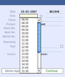

March 19, 200719 yr Author Hi LaRetta, I have made a clone of my database and stripped as much as i can out so i don't get any grief! I have put in only 1 booking under my name in the "Patient" database. If you click on the "time" field you will see the value list appear, values from 08:00 to 19:00 In the "Calendar" database you should see the booking, click on that booking and it brings up a small edit appointment window. If you click on the "time" field in there it brings up the same value list but with the :00's added onto all values. Most of the other things won't work on there as i've stripped it out but i think you should see my dilema. I'm all up for it being my mistake and happy to take the blame! I am concerned though that when you make a custom value list it displays it in the same way (00:00:00) As ever thanx for your time Mark B Clone.1.zip
March 19, 200719 yr Hi Mark, I looked at your files, and the formatting can be traced back to the Bookings entry as I suggested in my earlier post. If you go to the Bookings and then into Layout Mode, click on the [color:blue]AppointmentStartTime field, then the Format Time, you will see that you changed the format of the field to HH:MM. If you change this back to [color:blue]Leave Data as entered. and then go back to Browse Mode, and then click into the field, you will see that the data was entered using the HH:MM:SS format. HTH Lee

March 19, 200719 yr What do you get with these two? In case it doesn't work, try setting both files to 'Always use file's saved setting' (under File > File Options > Text). Clone.zip
March 19, 200719 yr Author Right, Well we're getting somewhere! try setting both files to 'Always use file's saved setting' (under File > File Options > Text). I set this and if i make another custom value list rather than the linked value list it does display as 08:00. I have also had to format the time field in the Patient database to be just HHMM rather than "leave as formatted" However, and there's always a however... If you change the time in the edit window in the calendar database, even though it is using the custom value list, it does put time in the field as HH:MM:SS. I understand that that is the way that FM deals with timing, ie from midnight but what i don't undersatnd is why both databases seem to deal with it differently. I think the Always use file's saved setting is part of the key here but i wonder if it is something to do with the SeedCode solution being written in a different version of FM. I only have FM Pro 8 but i think that SC was written in advanced and i'm wondering if it has a slightly different formatting set?
March 19, 200719 yr I don't think Advanced has anything to do with this. I do think (obviously) that Date & Time settings play a role here. I am not sure I understand exactly how, but my guess is that when the time has to be displayed in a DIFFERENT format, it goes thru another layer of conversion and loses the 'as entered' quality. In any case, I have not been able to reproduce the added seconds in MY files (same as you), though I can see it on the other files in this thread - until I set them to use their 'native' settings.
