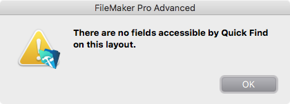

Can anyone reproduce this? It took me a while to find out why QuickFind was simply crashing my FileMaker 17. Clicking the cancel button... still removes the cancel button, but does not cancel the search (another old bug). Which forces me to kill FileMaker after 10 minutes of drinking coffee.  You are never sure that you did not miss any field that still has QuickFind enabled. With an XML clip editor, "quickfind=1" and "object flags="14"" seems to find objects with the QuickFInd flag on. I hope there will be a slightly less cumbersome way to find those object in the future.
I wonder why the QuickFind option doesn't follow the defaults either. The "include field for Quick Find" checkbox is greyed out when you have no objects selected in the layout. This slightly forgotten technique allows you to set field defaults, but the developers who created QuickFind apparantly weren't notified. Especially for QuickFInd, it is very important NOT to have it enabled by default, or it becomes a FileMaker killer. Especially if you cannot cancel a very complicated QuickFind in progress. I consider this yet another bug.
On 12/13/2014 at 4:41 PM, LaRetta said:
Go ahead if you're able to reproduce. I 've done my share of bug reporting, and would continue to do so, if it weren't so... unfulfilling. And I lost enough time already today because of these bugs.
Aha. You KNOW when you have disabled them all when you get this dialog when executing a QuickFInd:1437606985_ScreenShot2018-08-09at11_53_37.png.5b93116631b13b8b7635c93e68ddeacc.png
