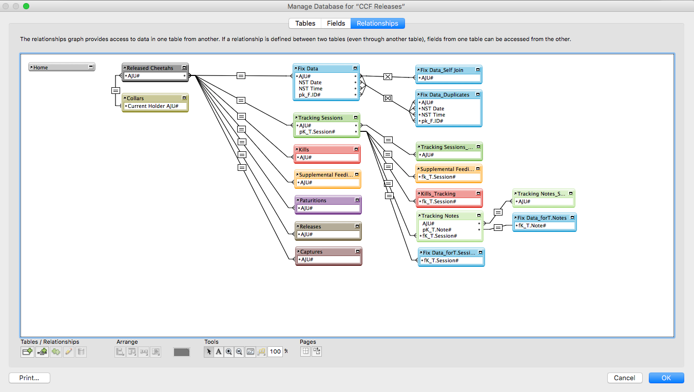

I've attached an image of my relationship graph in case that helps.
By your description, the relationship between Cheetahs and Kills is many-to-many. The "proper" way to resolve a many-to-many relationship is by using a third join table. However, Filemaker provides an alternative in the form of a multi-key field. This is very easy implement (all you need is a checkbox field in Kills to select the IDs of the cheetahs participating in the kill) - but has some limitations when producing detailed reports.
