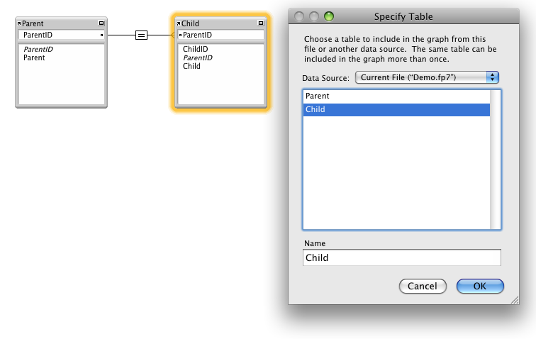

I am still not sure I understand what you want. If - as you said - you want to link an existing TO to another base table, then do what I said: double-click the TO itself (not the connecting line). Or select the TO and click the Edit button (the one with a pencil). Either of these will open the Specify Table dialog where you can assign the TO to another base table:
specify.png.016a0171679a6b1b107a8ff091fe
I am not sure what you mean when you say "delink the existing relationship". This has nothing to do with relationships.
