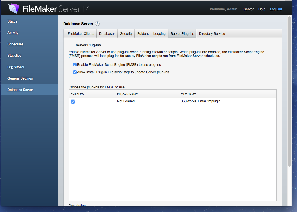

What sort of usage are you looking for? Installing the plugin on each client's computer is only necessary if you want to use the plugin functions client-side. If you're running everything server-side you won't need to install it on the client's computers. Same thing applies to registration, if you're only installing it on the server you only need to register it on the server. On server installs you need to register is as a script step in scripts that use the Email plugin.
But yes, that is the correct installation location. If it isn't loading please ensure you have the correct iteration of Java installed. On OSX you need this: https://support.apple.com/kb/dl1572?locale=en_US

In addition to what Caleb has said, if you have the Java 6 it may be that your Admin Console is just not updating when you enable the plugin. Restart your Admin Server by opening Terminal and typing the command "fmsadmin restart AdminServer -y" and then log back into the admin console to see if that remedy the problem.
