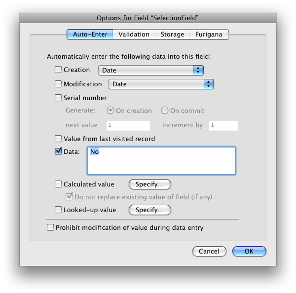

What i want is that when i create a new record  my check box field get auto selected the correct option.
How would i script that what ever i try doesn`t seem to get it working.
Please can someone help me out with this.
why script it when you can set the field to auto enter data "the value i want the check box to have on create"

how would i define to autoenter a radio box on creation?
i can`t seem to get it  , putting in set field "fieldtext" , but not giving me the results.
please can someone help me out
or auto enter in the data box putting in the radio box field name not getting the results
The same way as you would for any field. For example, this will auto-enter the value of "No" into a field that could be formatted as "Yes/No" radio buttons. Actually, the field's formatting on the layout has nothing to do with it - this is purely a data question. The same field could be formatted as radio buttons on one layout, and as an edit box on another.
ae.png.33f6054dd2de699b0915cbe1421a968e.
See also: http://www.filemaker.com/help/14/fmp/en/html/create_db.8.24.html

Actually what i see is in a edit box field it show up the correct answer however in the radio box field of the same field in the same record and table the radio box is not highlighted
I don't think this is related to your original question. In any case, what you see indicates that the value entered is not exactly the same as the one in the value list. For example, one of them could have a trailing space.

If the list that sets the choices for your radio./ checkbox has list items Blue, Orange and Pink  where Blue and Pink are 4 chars and Orange is 6 chars and you set the field to anything other than Blue with 4 chars, Pink with 4 chars or Orange with 6 chars the control will not show as selected.

Can you show us your auto-enter data, and your value list? This sounds like the data being entered is, for some reason, not an *exact* match for any of the values in the value list...
Then your file works as you desired.
@webko
H sent me their file by Private Message and I verified that his auto enter calculation works as desired.
Ah, all good...
