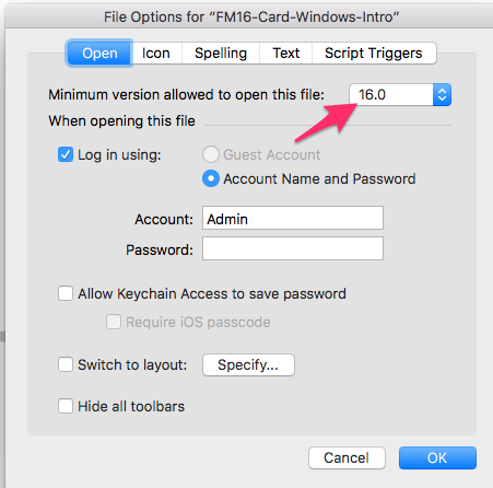

Change the file options, but remember any of v16 "New to this release" will not work.
File >> File Options >> Open

Hi Lee, I'm not sure what you mean. Change the file options for Minimum Version Allowed? ... and yes, I understand that .fmp12 has been standard for a while, thanks.
Thank you, I appreciate your help, but I'm don't think you understand my problem. I am unable to Export Records from v16 even though this works from v15. Opening or importing files is not an issue.
