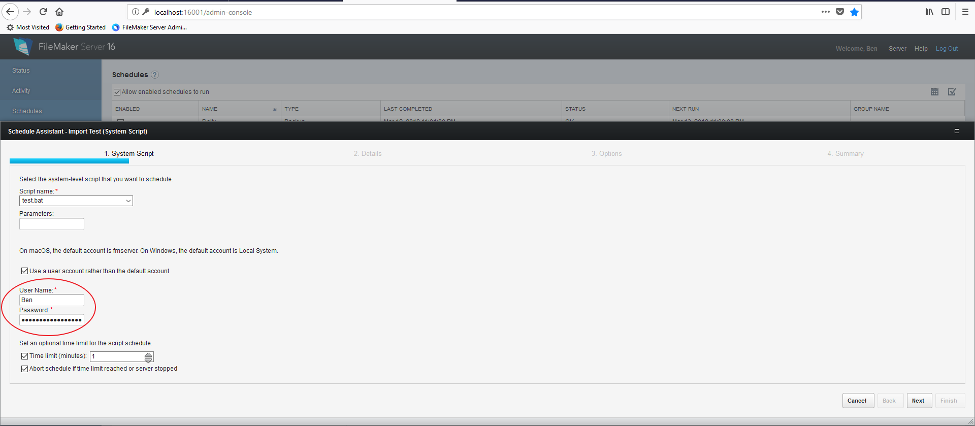

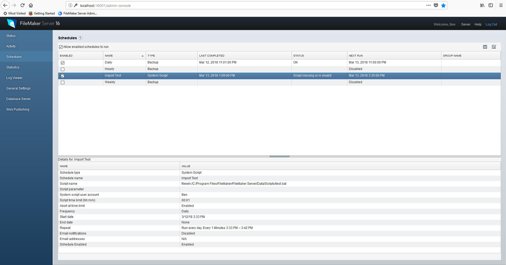

I am writing a system script that needs to be run using an admin account on a Windows Server 16 machine. However when I try to set this up it says that the script is missing or invalid.
The login details I am entering are to an admin account on the local Windows Server 2016 machine. I have tried both these, and the default administrator account.
If I try to enter the login details for the FMS16 account it says Invalid account.

Screenshot 1 shows the option I am talking about. For the test if I do not tick this then it executes fine.
Screenshot 2 is showing that it comes up as missing or invalid.

A bit late to the party, but I ran into this issue now and thought I'd provide my solution in case it helps someone.
I found out that you need to provide the domain name also on Windows, even if you are using a local account.
Something like: MyWindowsServer\administrator
You can find your complete user name by running the command whoami in the command console.
